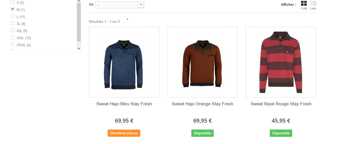

Gilles6688 Posted December 3, 2020 Share Posted December 3, 2020 Hello, I have make those modifications but I have the good answer in the left side but it don't show me the good answer, Why? Thanks Link to comment Share on other sites More sharing options...
