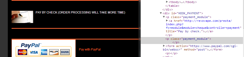

genoknave Posted September 27, 2013 Share Posted September 27, 2013 Hello, I am having trouble locating the proper file to edit to remove an extra payment module that is blank. It is giving me an issue with the way my borders are displaying. This is the URL: http://revovape.com/presta/index.php?controller=order&multi-shipping= At the end of the order process, there is an extra border right above the paypal logo. I have it set to bottom borders for the table and there is a blank <p> </p> in the source code causing it. I have attached a picture as well to show the issue. Any help would be greatly appreciated! Link to comment Share on other sites More sharing options...

genoknave Posted September 27, 2013 Author Share Posted September 27, 2013 Thanks for the reply. When I go into the positions page through the back office, it only shows two payment modules. Paypal and payment by check. I removed the wire transfer option which I am assuming is causing the problem. Is there a specific tpl file that I can edit to remove the extra paragraph? Link to comment Share on other sites More sharing options...
NemoPS Posted September 27, 2013 Share Posted September 27, 2013 I see! Sorry I meant between check and bankwire, my mistake. THis is really weird, nothing is hooked between them? Can you try sorting them and see what happens after saving? Link to comment Share on other sites More sharing options...
