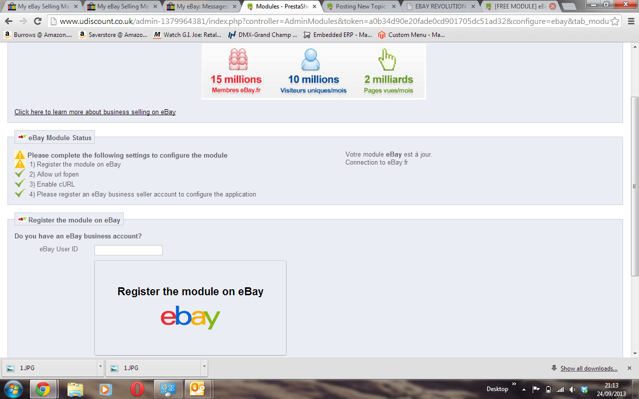

udiscount Posted September 24, 2013 Share Posted September 24, 2013 Hi there I have downloaded the ebay module but I am not having much luck When i try to link up my ebay and the module it opens up ebay.fr , even though i tried to log in but i am still stuck on the first screen Please help Link to comment Share on other sites More sharing options...

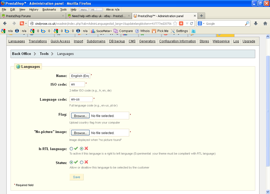

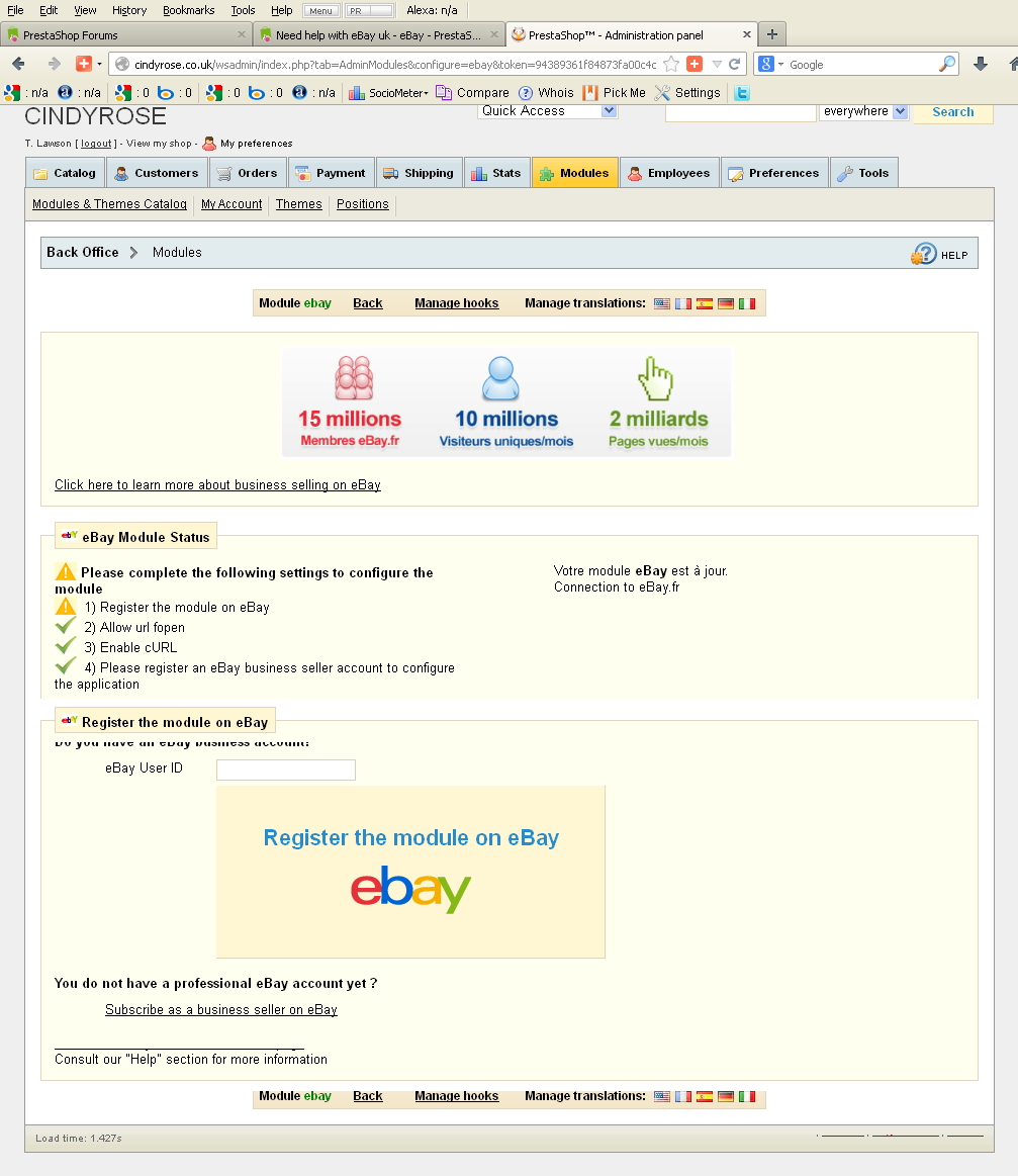

wolfstores.com Posted October 19, 2013 Share Posted October 19, 2013 (edited) Hi There, I have the same issue with the module, v1.5.3 by PrestaShop, always connecting to ebay France. My version of Prestashop is 1.4.4.0. I have tried all of the above and nothing works. Could someone please give me more detailed instructions on how you managed to connect to ebay UK? The default language is currently en-us (see attached jpg) Is it good enough simply to change en-us to en-gb and click save? I have also tried the fix suggested If you have access to an SQL manager, go look in ps_configuration table, find EBAY_COUNTRY_DEFAULT and set the value to ID of the UK within Localization->countries. (17 usually.) In the attached jpg it shows that the module is trying to connect to ebay France. When I change via PhpMyAdmin the above from 8 to 17, delete the module and re-upload it, it says that it will connect to ebay UK. But when I click the button to connect it again re-directs to ebay France... Since this fix did not work I changed 17 back to 8 as it was originally. Any ideas please? Thanks. Edited October 19, 2013 by wolfstores.com (see edit history) Link to comment Share on other sites More sharing options...
