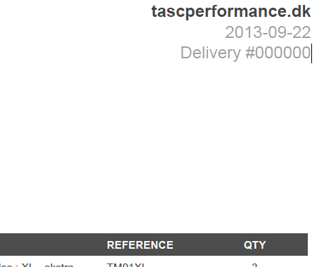

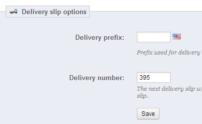

JohnADK Posted September 23, 2013 Share Posted September 23, 2013 (edited) Everything appears to work correctly when an order is placed and processed EXCEPT that the delivery slip does not include the delivery slip number on the print out. It just shows a series of zeros. What needs to be corrected for this to show the correct delivery slip number? See attached screen shot for an example. This is for order number #300 (AWZMNOJBI) in my shop, and the invoice number has also been correctly auto-generated as Invoice #000395. The only thing missing is this delivery slip number. What do I need to fix for this to work? And, yes, I have already set the start sequence number in the Delivery Slip setup, as can be seen from the other screen shot, to 395. I hope someone can assist me with this wee issue. Edited September 23, 2013 by JohnADK (see edit history) Link to comment Share on other sites More sharing options...

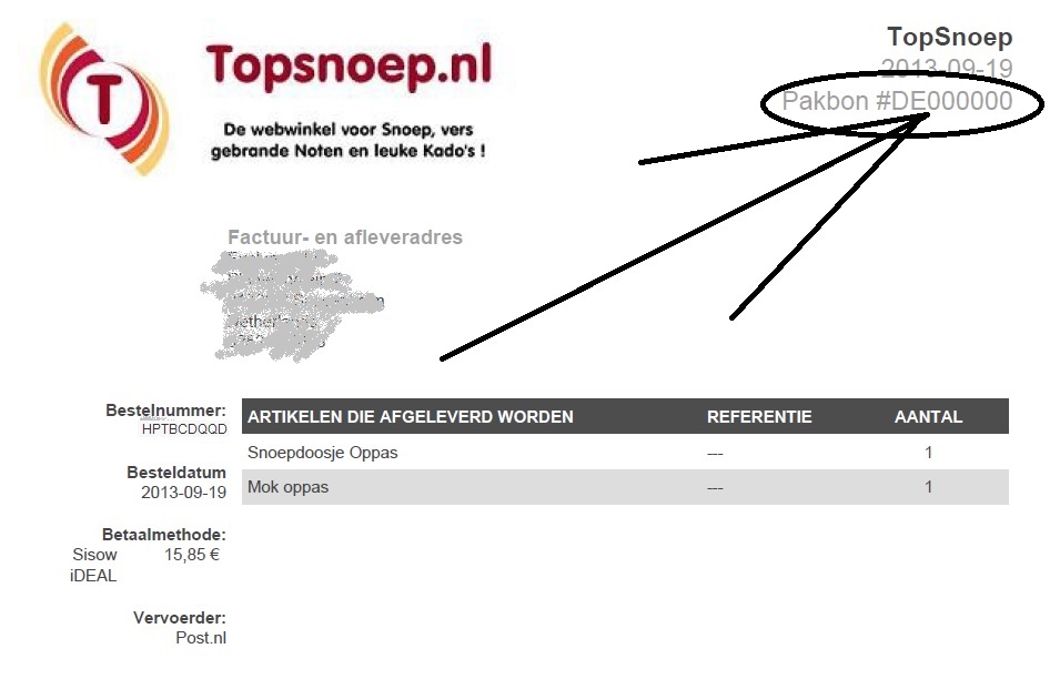

musicmaster Posted October 14, 2013 Share Posted October 14, 2013 There is no dispute that "Delivery in progress" can give a delivery slip. Problem is that it has number zero. See attached image. It is a bit weird to send such a document to your customer. Link to comment Share on other sites More sharing options...
