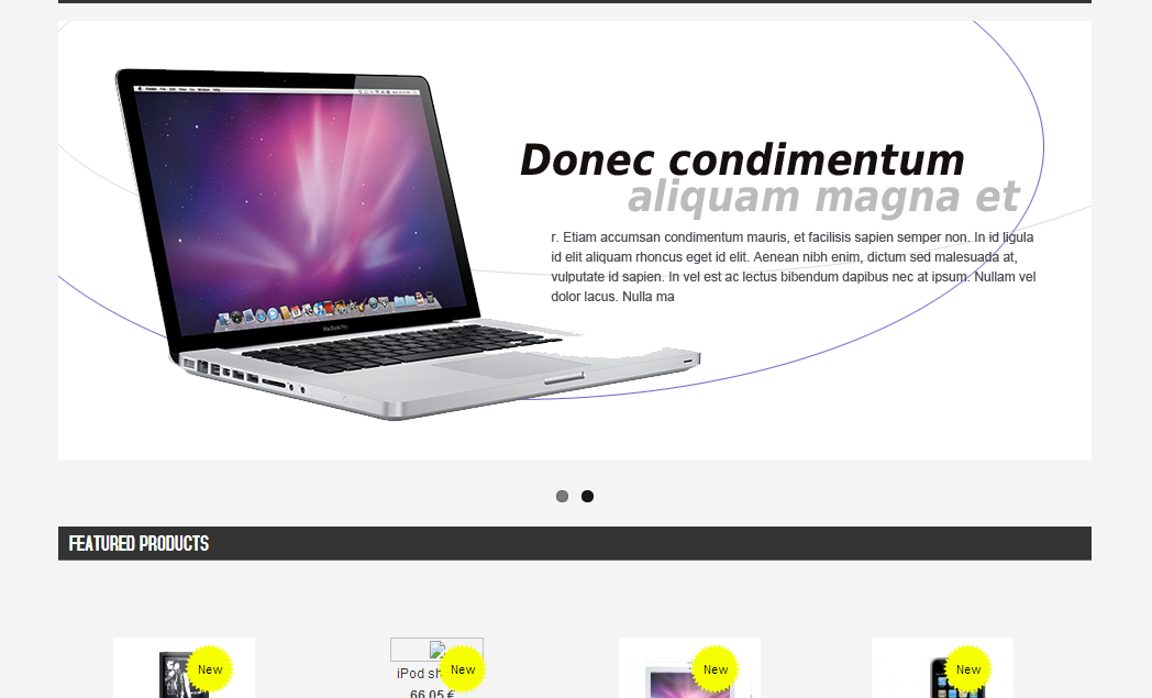

cschnell Posted September 22, 2013 Author Share Posted September 22, 2013 I would like to display what's currently there the image slider and featured products (see attached) I'm not sure how this is built and where to change the options for this. in the other image I attached is the submenu displayed which I only want to appear in the horizontal menu but not part of the 'home' tab does this make sense? Link to comment Share on other sites More sharing options...

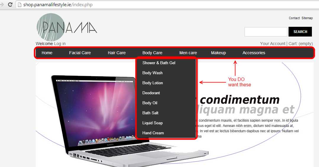

stottycabanas Posted September 22, 2013 Share Posted September 22, 2013 cschnell, please see attached images and say if that's what you want to achieve. Thanks, Dave Link to comment Share on other sites More sharing options...
gosewinus Posted September 24, 2013 Share Posted September 24, 2013 (edited) cschnell, please see attached images and say if that's what you want to achieve. menu.jpgmenu2.jpg Thanks, Dave Hi Dave, That is what I'm looking for. A navigation bar with options for submenuing. I can activate the option maincategory yes/no BUT it don't make any difference. The shop in development is my third in Prestashop, but the problems with the horizontal bar are annoying and timesteeling. At the moment I cannot figure out, why start, Ipod and Accessesories are maincategories and NO MORE can be added. I deleted the Ipod-category out of the list in backoffice/modules/horizontalnavbar... now I cannot see it anymore in the menubar(navbar) AND I cannot reactivate this category. PLEAAAASE give me a hint. Best regards from Stuttgart/Germany Edited September 24, 2013 by gosewinus (see edit history) Link to comment Share on other sites More sharing options...
stottycabanas Posted September 25, 2013 Share Posted September 25, 2013 I can activate the option maincategory yes/no ....... I deleted the Ipod-category out of the list in backoffice/modules/horizontalnavbar.. Not sure what you mean by the above statements - are you using a third-party module? The standard module in Prestashop is called Top Horizontal Menu, with files stored in /modules/blocktopmenu. I'll assume for now that's what you're referring to. If you select Modules/Modules then find Top Horizontal Menu and click Configure, you get a screen that looks like this: To achieve what I suggested in my last post, do as follows: In the right-hand box, select all entries than click Remove In the section Add Menu Top Link, create an entry using 'Home' as the label and the URL for your home page as the link. When you click Add, a section called List Menu Top Link will appear Then In the left-hand box under Settings, scroll to the bottom & you will now see an entry 'Home' under Menu Top Links. Select this then click Add to place it as the first item in the right-hand box Scroll back up the left-hand box to the Categories section. Here you will see the category structure that you have set up via Catalog/Categories. Select the category you want to appear next to Home on the top menu, then click Add Do this for each category you want in the top menu, in the order you want them to appear When the right-hand box has all the entries you want in the top menu, click Save Now check on your website that the top menu is as desired. Cheers, Dave Link to comment Share on other sites More sharing options...

cschnell Posted October 4, 2013 Author Share Posted October 4, 2013 Hi Dave only seeing this now I want to achieve Home 2 image thanks for your help Link to comment Share on other sites More sharing options...
cschnell Posted October 4, 2013 Author Share Posted October 4, 2013 hi dave sorry somehow never saw this until now I want what you showed in Home 2. tried the suggested solution from you but then get a 404 error? I want to have the same look that i have now with the slide show and featured products ( that doesn't work correctly either). Currently I use the Home (My Store) option under the categories. Also the other thing I don't want is to show the categories on the pages only the products. any idea? thanks Link to comment Share on other sites More sharing options...
