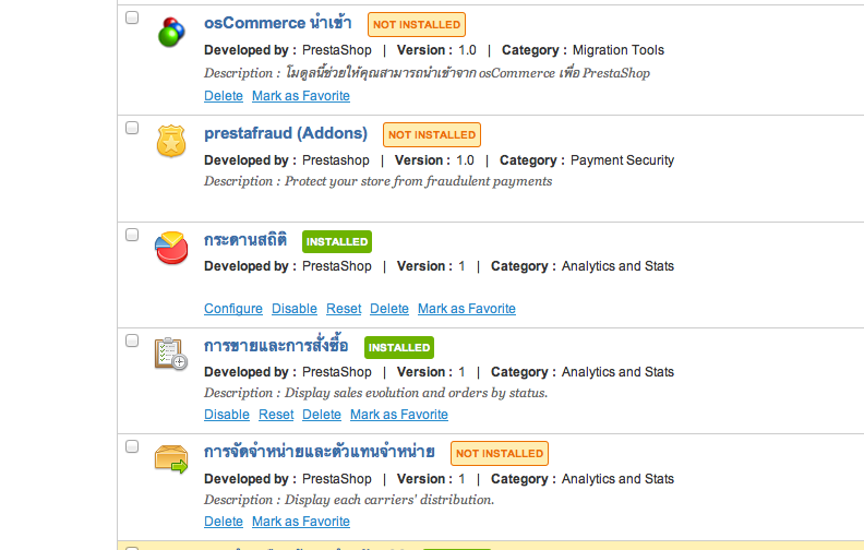

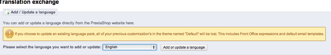

Presta1.5.4.1Newbies Posted September 18, 2013 Share Posted September 18, 2013 This error has happened after I deleted all the additional language : Chinese, Thai, Korean and then re added in back office. http://grandcoralaustralia.com.au/psadmin/index.php?controller=AdminLanguages&submitAddlang=1&token=628e62801d4f4a35b88af97054073058 Attached is the error report DatabaseException.txt Once I restarted it seems to be normal but I think the problem is existing. Another problem is I tried to manually translate module in backoffice but nothing changed and effective. Link to comment Share on other sites More sharing options...
PascalVG Posted September 18, 2013 Share Posted September 18, 2013 Hi Xara (สวัสดี) It looks like you have a module called 'Innovative Menu' or so that gives problems when adding new languages. maybe reset this module (Did you add many things to this 'menu'? Keep a record what you have to add/change then first!) and see if that helps. About the translation. Try the following: Check with your host if they turned off/can turn off "mod_security" on your site. (Tell them it interferes with your e-commerce site) There's also an option within Prestashop for it, but not sure if that works well. (Preferences->SEO&URLs. Scroll down to URL's block, last item here). You can try that first before you contact your host. Hope this helps, pascal Link to comment Share on other sites More sharing options...

Presta1.5.4.1Newbies Posted September 24, 2013 Author Share Posted September 24, 2013 I have tried to fix that by manual translation. And also update in back office but most of the modules are still in Thai. My default language in back office is ENGLISH and has only default theme Link to comment Share on other sites More sharing options...

PascalVG Posted September 26, 2013 Share Posted September 26, 2013 Hi Presta, the back office language is stored per employee. Login your back office and click My preferences at the top right. You go to your own employee -> edit page, where you can edit the language you want to use in back office. (probably still on Thai at the moment) Hope this helps. Were there other points still open? pascal Link to comment Share on other sites More sharing options...
