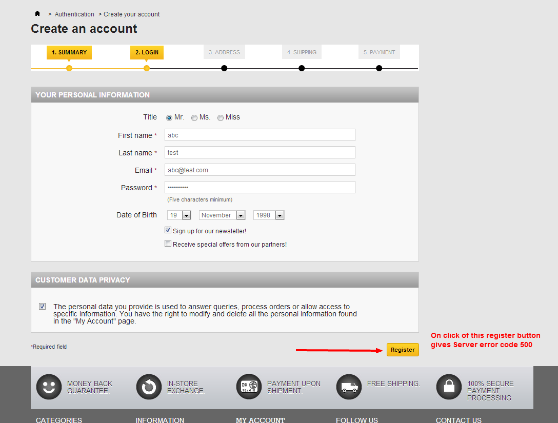

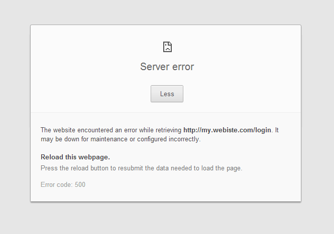

prestashop-new Posted September 9, 2013 Share Posted September 9, 2013 Good Evening ! I am new to PrestaShop and I have configured a Shop. I am getting a server error during check out process when we enter email id in order to register. As soon as I click on Register button it gives Following Server Error on Chrome Browser : The website encountered an error while retrieving http://my.website.com/login. It may be down for maintenance or configured incorrectly. Reload this webpage. Press the reload button to resubmit the data needed to load the page. Error code: 500 Attached is the screen shots. Please Guide ! Thanks ! Link to comment Share on other sites More sharing options...
