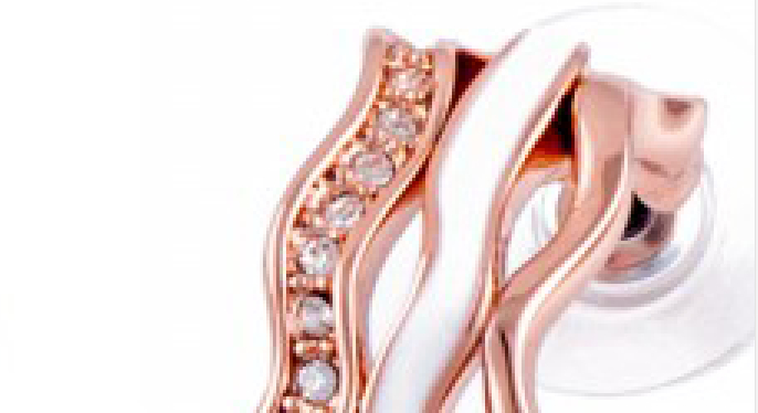

Auseagle Posted September 9, 2013 Share Posted September 9, 2013 hi guys, i really need the helps in here, this is so urgent to our website. we are using Prestashop 1.4.9(Because the theme doesn't work in latest version, sorry), and we try to upload white background jpg picture for all of our products, but after uploading, all the thumbnails(normal, large, home etc) are having a strange background lines in each picture. please have a look the attached files, i also attached images.inc.php in there. please let me know what should i do about it. i searched a lot on forum, i think it's related to images.inc.php file. please help! thanks a lot! Appreciated! Strange picture.tiff strange picture 2.tiff images.inc.php Link to comment Share on other sites More sharing options...
PascalVG Posted September 9, 2013 Share Posted September 9, 2013 Hi Auseagle, I assume you mean the strange curves in the upper right upper corner, right? A few questions: - What format do you use to upload the pictures? - What Image quality setting do you use? (Preferences->Image) - Do you have a link to a page that shows the problem? -The pictures you show, did you save them using right click-> save, or grabbed them from the screen? (I ask, as there may just be something 'OVER' the picture that shows like it's IN the picture. A watermark or so, or a corrupted 'New product' icon or so) - When did the problem pop up? What did you just before it started? Added things in B.O., changed any php/tpl/?? file? pascal 1 Link to comment Share on other sites More sharing options...

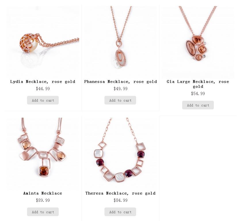

Auseagle Posted September 11, 2013 Author Share Posted September 11, 2013 Hi Pascal, thanks for your reply. if you clearly look at the whole picture, you can see some small lines are everywhere in the picture. for the questions you requested, i asked them in blue: - What format do you use to upload the pictures? JPEG- What Image quality setting do you use? (Preferences->Image) i am using JPEG 90.- Do you have a link to a page that shows the problem? www.tiviss.com, if you check on all pictures, you will see it better.-The pictures you show, did you save them using right click-> save, or grabbed them from the screen? (I ask, as there may just be something 'OVER' the picture that shows like it's IN the picture. A watermark or so, or a corrupted 'New product' icon or so) i made a pure white background picture from PS, and there's nothing wrong on the pictures by itself, it's only doing it after i upload them onto website.- When did the problem pop up? What did you just before it started? Added things in B.O., changed any php/tpl/?? file? those picture were grey background before, but we found that it's not good enough to show the product, so we used PS to make every picture into white background. Thanks a lot! Link to comment Share on other sites More sharing options...

Auseagle Posted October 4, 2013 Author Share Posted October 4, 2013 i tried like 3 computers (2 Wins, 1 Mac), they all have the lines, Wins hardly notice that, but it's much visible on Mac. Link to comment Share on other sites More sharing options...
PascalVG Posted October 10, 2013 Share Posted October 10, 2013 Hi Auseagle, last try: With the files that you sent me, can you EDIT file: 121-135-thickbox.jpg you say you see error lines in here. Are they clearly visible to you in the editor? if so, If you zoom in onto the picture, are these error lines magnified as well. As they still clearly visible to you (Maybe even clearer)? If so, please put a circle around one or more places where you clearly see these error lines and send me the picture with these circles one more time so i can hopefully see what you mean. Getting nuts over this one... pascal Link to comment Share on other sites More sharing options...
PascalVG Posted October 10, 2013 Share Posted October 10, 2013 Auseagle. I see them. Very subtle lines indeed.... pfew, need an eyedoctor indeed! Let me see if I can find the problem of it some more, now that I see the result. Link to comment Share on other sites More sharing options...
PascalVG Posted October 10, 2013 Share Posted October 10, 2013 Update: Interesting: Now understand why I didn't see them first. Opened them in Photoshop and this program fixes the problem automatically! This morning I opened them in another app, and there I (finally) saw them. Image Auto-fixed in Photohop 1 Link to comment Share on other sites More sharing options...

Auseagle Posted October 18, 2013 Author Share Posted October 18, 2013 Thanks a lot guys, i also attached another screenshot here maybe that will have a much visible of them. i have changed the jpeg quality to 100, please help~ Link to comment Share on other sites More sharing options...
