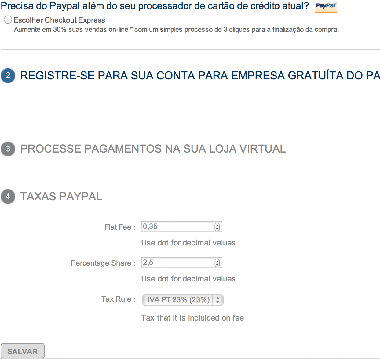

jose_rui_sa Posted September 4, 2013 Author Share Posted September 4, 2013 yes i know... like i said the developer already knows this issue and is probably working on this... for now I wanna put the paypal "original" module working, but like I said copy the modules folder the paypal module dont works check the attach. Im still getting files or in DB or somewhere from older paypal. Fo unistall I just disable the module and delete it... But if I login by ftp the module keeps there, I delete it, and installing the new fresh paypal... still the "wrong data" from older... And now if I try to open http://saeletronica.com/admin1238/ Im getting the error...Parse error: syntax error, unexpected '{', expecting T_FUNCTION in /home/joserui/public_html/override/classes/order/Order.php on line 6 If I use this link (with token) I can login.... http://saeletronica.com/admin1238/index.php?controller=AdminMaintenance&token=c30a9575d07313754d73e3073c11be Link to comment Share on other sites More sharing options...
