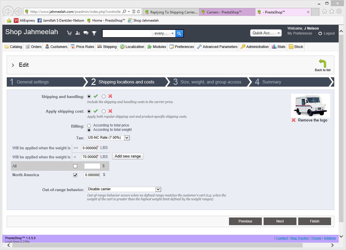

jnelson Posted September 23, 2013 Share Posted September 23, 2013 I'm having a similar frustrating issue. My shipping section does not have "Free Shipping" enabled; yet my cart from a customer's perspective (in the 5 step checkout) keeps showing Free shipping and it will not show my carriers (USPS module). Screenshots of backend are attached. I'm also noticing that sometimes my taxes calculate a few cents off. All state taxes and tax rules are enabled. All products are set up the same way. Hopefully someone can help me PLEASE. Thank you SOOOOOO much! Link to comment Share on other sites More sharing options...
benjamin utterback Posted September 23, 2013 Share Posted September 23, 2013 I'm having a similar frustrating issue. My shipping section does not have "Free Shipping" enabled; yet my cart from a customer's perspective (in the 5 step checkout) keeps showing Free shipping and it will not show my carriers (USPS module). Screenshots of backend are attached. I'm also noticing that sometimes my taxes calculate a few cents off. All state taxes and tax rules are enabled. All products are set up the same way. Hopefully someone can help me PLEASE. Thank you SOOOOOO much! Hi, according to your shipping wizard set up. All carts that weigh between 0-70 Pounds will have free shipping. Have you set up your weights for your products? Remember that your USPS module configuration is different than your shipping carrier configuration that you use in the module. The USPS module uses different configurations for things like handling charges and free shipping. Try to change the Handling Charge of 2.50 to 0 in the Shipping/Shipping screen. Then, add the price of $2.50 in the Shipping Wizard. It should show up then. Link to comment Share on other sites More sharing options...

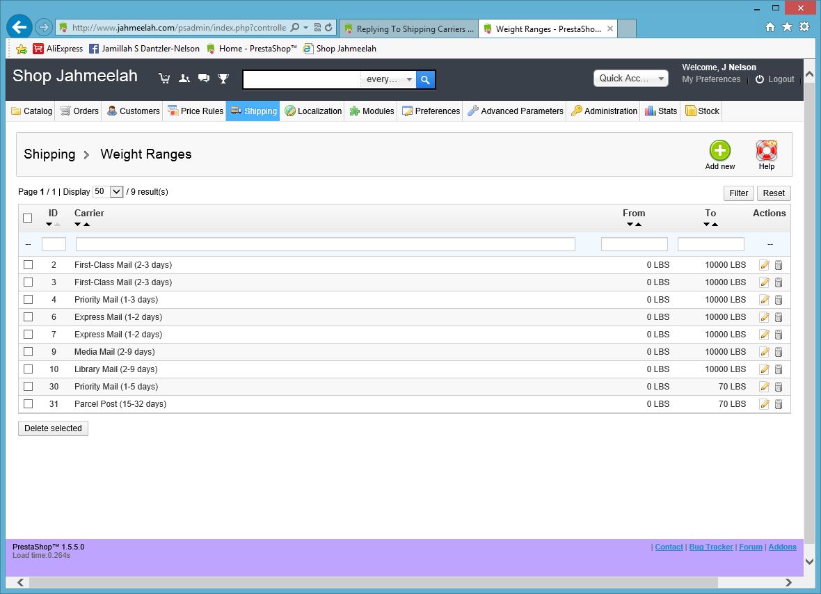

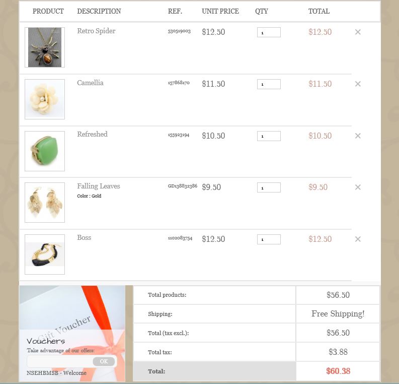

jnelson Posted September 25, 2013 Share Posted September 25, 2013 The weights for my products were already set. As far as the USPS Module, I rest it just in case there was an issue within it. I also made the changes you provided and the shipping still cones up as "free shipping" and not showing my carriers during customer checkout. Link to comment Share on other sites More sharing options...
benjamin utterback Posted September 26, 2013 Share Posted September 26, 2013 I understand, but in the screenshot of your cart that you provided. You showed a total of 5 products. If those products combined weight was less than 70 lbs, then a customer would get free shipping according to your ranges and prices. Link to comment Share on other sites More sharing options...
