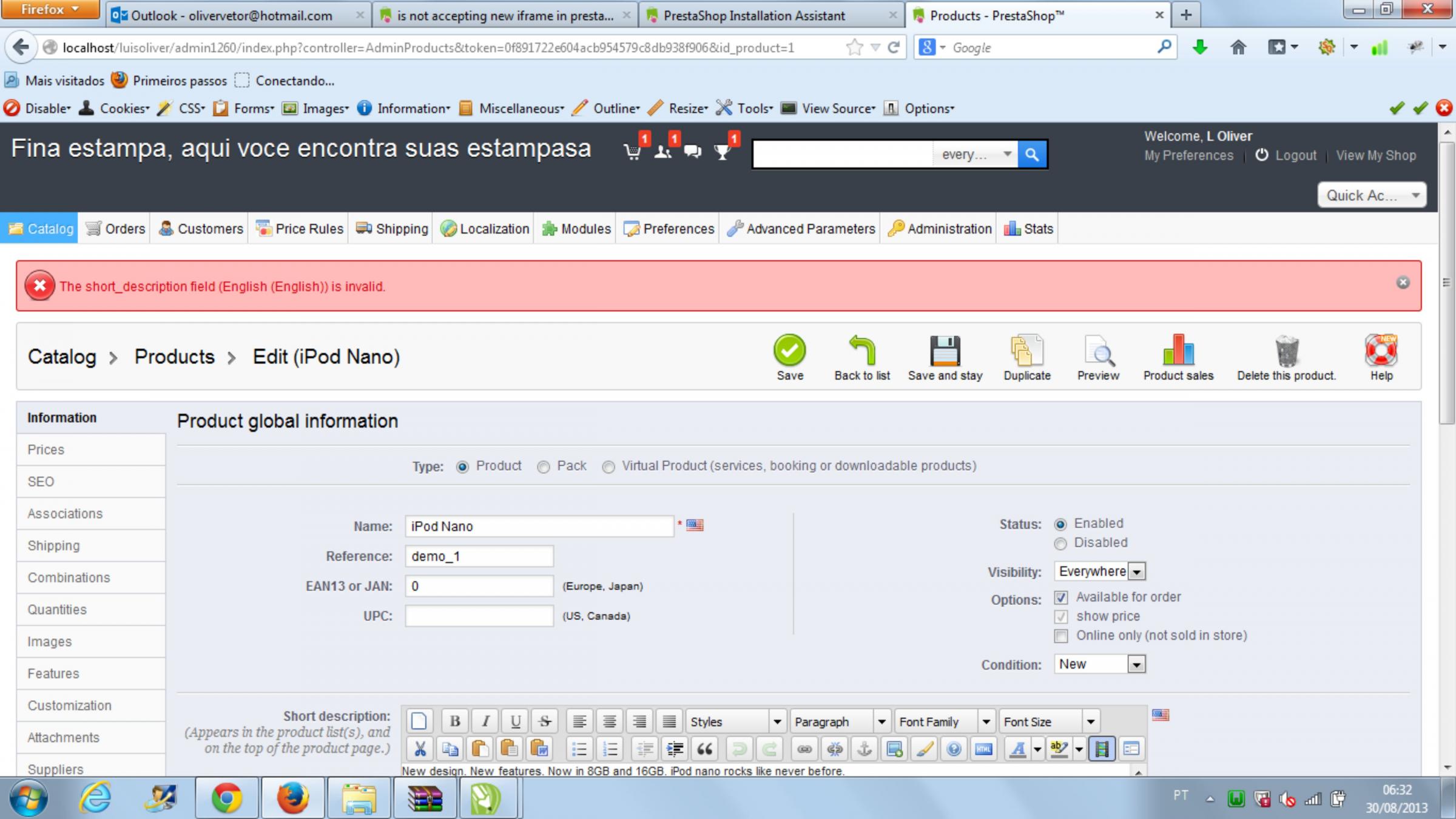

luisoliver Posted August 30, 2013 Share Posted August 30, 2013 hi in the registration of products in prestashop 1.5.4.1 gave to put youtube music video as the soundcloud with more iframe code in this new version 1.5.5.0 iframe is not accepting it happens time for registration of products is the brief description or the description is not accepting can not save the error saying q is wrong is not accepting new iframe in prestashop 1.5.5.0 the description and short description of the error and save Not Made Link to comment Share on other sites More sharing options...
vekia Posted August 30, 2013 Share Posted August 30, 2013 in the html code, when you insert iframe manually, after save it disappear from code? or what? you said that you've got message "...saying q is wrong..." this is full error code? 1 Link to comment Share on other sites More sharing options...

vekia Posted August 30, 2013 Share Posted August 30, 2013 can you try with this: go to classes/Products.php there is a code like: 'description_short' => array('type' => self::TYPE_HTML, 'lang' => true, 'validate' => 'isCleanHtml'), remove the 'validate' => 'isCleanHtml': 'description_short' => array('type' => self::TYPE_HTML, 'lang' => true), and try again and let me know if this will work or not Link to comment Share on other sites More sharing options...
luisoliver Posted August 30, 2013 Author Share Posted August 30, 2013 I tried like you said I will not work more funiona shows how the prestashop version 1.5.4.1 look there a product that signed up Link to comment Share on other sites More sharing options...
vekia Posted August 31, 2013 Share Posted August 31, 2013 okay, so make sure that you've got this option turned on: it's a part of preferences > general tab in your back offie. Link to comment Share on other sites More sharing options...
luisoliver Posted August 31, 2013 Author Share Posted August 31, 2013 ok it worked thanks for the help I tested and everything is fine now Link to comment Share on other sites More sharing options...
