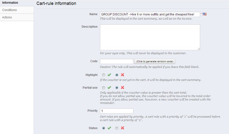

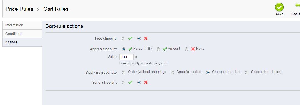

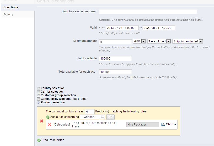

Barry1877 Posted August 27, 2013 Author Share Posted August 27, 2013 Thanks for your reply, images attached. As you will see if someone chooses 6 of the hire packages they get the cheapest free (which is what I want) however if they add other products and that is cheaper the discount is applied to that not the hire package. Appreciate you taking a look Link to comment Share on other sites More sharing options...
