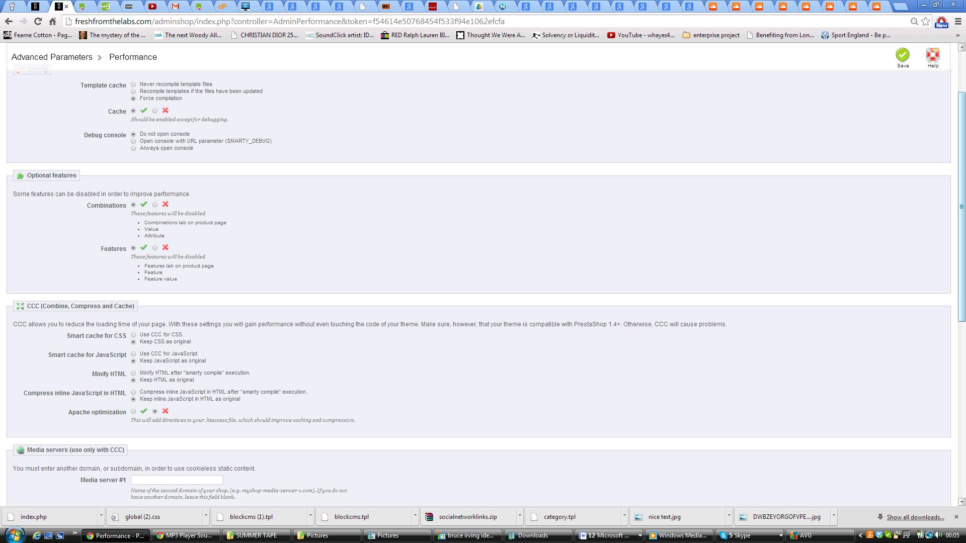

nickelus Posted August 27, 2013 Author Share Posted August 27, 2013 Does this help in any way?? Link to comment Share on other sites More sharing options...
PascalVG Posted August 28, 2013 Share Posted August 28, 2013 Hi Nickelus, About the settings: One clear bottleneck we see here is the first field Template Cache: force recompile. Set this to : - 'Template cache' set to choice 2: "Recompile templates if the files have been updated" (or choice 1: never recompile, but then don't forget to temporarily turn it to choice 2 or 3 whenever you change any file, to see the changes take effect. choice 2 is set and forget state :-) - you can turn on all ccc caching and apache optimization, but beware: some people on the forum sometimes noticed problems here, rendering the site actually slower, so try (test separately from template cache point above) and see if this indeed improves the things, or not. - Down below there is another field: caching this caches the database query results, speeding up things as well. See if your host supports. Many do support 'memcached', so try by turning this on and do repeated requests of the same page (like choose catalog page with many products on it) and see if the second++ time it becomes faster. Don't forget if you ever want to make combinations or add features to your products to turn those options on in this menu. This is easily forgotten and causes headaches why these options are gone on your edit-product page... Hope this helps, pascal Link to comment Share on other sites More sharing options...
