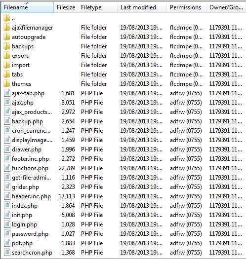

602 Posted August 20, 2013 Author Share Posted August 20, 2013 List of files contained in the Admin directory after install. Is there anything missing? Link to comment Share on other sites More sharing options...
vekia Posted August 20, 2013 Share Posted August 20, 2013 everything looks well there, it's really weird that it doesnt work. can you for test purposes create simple hello.html file in your admin dir does it work if you try to open it in browser? Link to comment Share on other sites More sharing options...

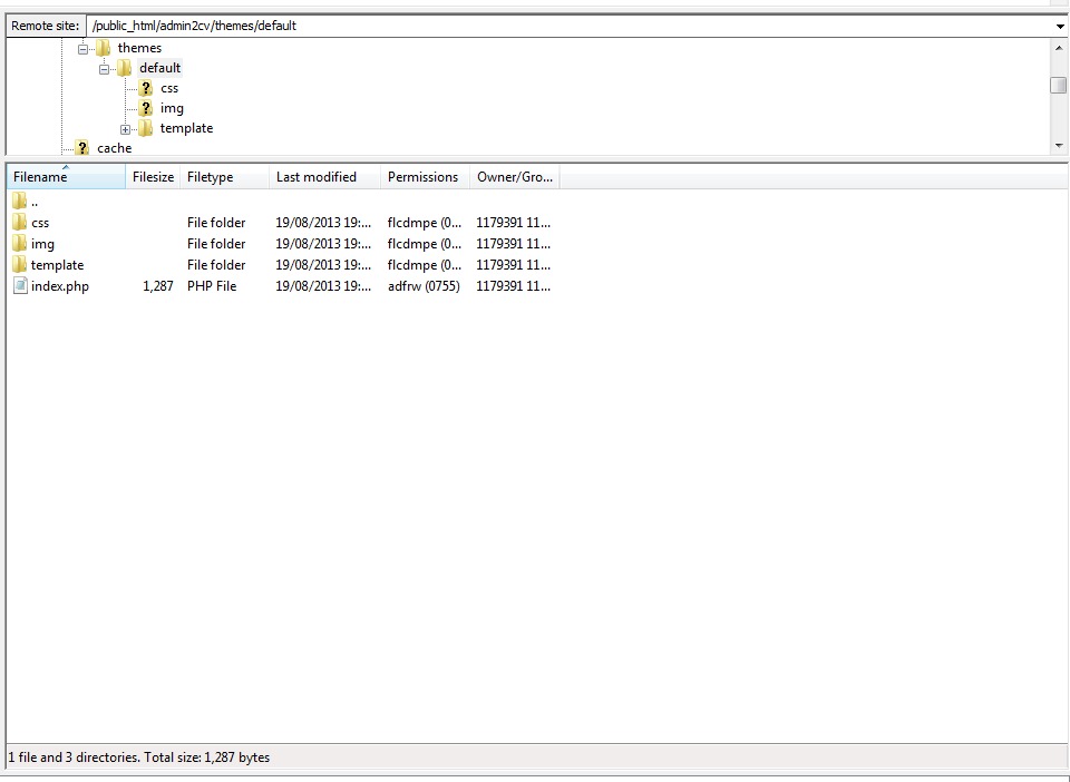

vekia Posted August 21, 2013 Share Posted August 21, 2013 can you check /admin/themes/default/ directory ? this is a template for back office (you've got problems with BO, so i suppose that there is something wrong) Link to comment Share on other sites More sharing options...
602 Posted August 21, 2013 Author Share Posted August 21, 2013 Not a lot in that directory [see attached] Link to comment Share on other sites More sharing options...
vekia Posted August 21, 2013 Share Posted August 21, 2013 and in themes/default/template/ ? does the directory look like this: Link to comment Share on other sites More sharing options...
602 Posted August 21, 2013 Author Share Posted August 21, 2013 Just compared the templates folder in that directory with that on my local PC. There were a lot of files missing. Uploaded those and guess what, I'm in Thanks for your help. Link to comment Share on other sites More sharing options...
