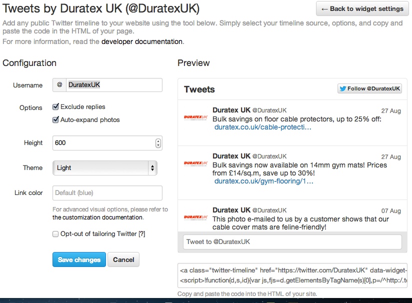

PascalVG Posted August 29, 2013 Share Posted August 29, 2013 (edited) OK, here we go: Download this free module: It allows you to just put any kind of HTML/Javascript/images/text on your page: - go to: http://contentbox.org/ - Just push the download button (don't have to generate one, just use default one. (If you need more boxes like this, just 'generate' one, it will change the name a little, so that it can live next to another contentbox-module, without interference) When downloaded: - upload the zip file to your /modules folder and extract (or, if you use ftp, extract on your computer, and upload the folder 'contentbox' to the /modules folder) - Go to modules->modules, find contentbox and press install. - Then go there again and press configure. You will see a white field with some layout buttons above it, just like a description field of products. Press the small blue 'HTML' button in the button bar of this field. Remove all old text replace with the following text: <p><a class="twitter-timeline" href="https://twitter.com/DuratexUK" data-widget-id="372011630957060096">Tweets by @DuratexUK</a></p> <script type="mce-text/javascript">// <![CDATA[ !function(d,s,id){var js,fjs=d.getElementsByTagName(s)[0],p=/^http:/.test(d.location)?'http':'https';if(!d.getElementById(id)){js=d.createElement(s);js.id=id;js.src=p+"://platform.twitter.com/widgets.js";fjs.parentNode.insertBefore(js,fjs);[spam-filter](document,"script","twitter-wjs"); // ]]></script> - Press Update - Press Update (save) - have a look at your front page. See if it works. Hope this does the trick. ----------------------------------------- If you are curious there the text comes from, or want to make some tweaks: go to twitter.com press the settings icon (top right) press widgets press create new add your twitter name (@duratexuk) make any changes you like (height of box, theme, etc) get widget text bottom right copy as said before in custombox That's all. pascal Edited August 29, 2013 by PascalVG Added image (see edit history) 1 Link to comment Share on other sites More sharing options...
mowax Posted August 29, 2013 Author Share Posted August 29, 2013 Hi Pascal, Thanks for this solution, I guess it is better than a module which hardly ever works! That said I didn't get the widget to appear, only the <p> tag, but will look further into it. Just so I'm clear though, what was the problem I had? Was it with twitter, the rss block module, or something else? Cheers Mo Link to comment Share on other sites More sharing options...
PascalVG Posted August 29, 2013 Share Posted August 29, 2013 Hi mowax, Hope you can make it work. Otherwise make a temporary employee with admin rights and send me the login/password details, then I will do it for you :-) The problem seems to be the site that creates the rss feed. It took (mostly) only one post at the time, not many/all. Maybe it was possible to change a setting on that site or so, but I couldn't find any that quickly. This seems to be a working solution, though, so let's try to get this to work. Let me know if you need help with it, pascal. 1 Link to comment Share on other sites More sharing options...
PascalVG Posted August 29, 2013 Share Posted August 29, 2013 Did you press the small HTML button, before you pasted the code into the field? Link to comment Share on other sites More sharing options...
PascalVG Posted August 30, 2013 Share Posted August 30, 2013 Summary, block didn't expand after copying the text form my post before. Solution: Go to twitter.com and re-generate the script following steps in post #16 (at the end) Problem solved, pascal Link to comment Share on other sites More sharing options...
