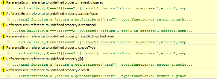

TDsouza Posted August 19, 2013 Author Share Posted August 19, 2013 (edited) the problem is probably related to the ajax script error (js parse error or error related to the php script parse) please check browser console log for more informations, if any error appear there - please paste error contents here Ok, im using firebug, and the console showed me nothing, but then I enabled all they types of error and warning messages from the console. After this, clicking on submit provided me with some errors that I have attached here. Edited August 19, 2013 by TDsouza (see edit history) Link to comment Share on other sites More sharing options...
vekia Posted August 19, 2013 Share Posted August 19, 2013 is there any chance to test your website? if so, please share the url. for now im totally lost, it's hard to say what's goin on without little investigation Link to comment Share on other sites More sharing options...
