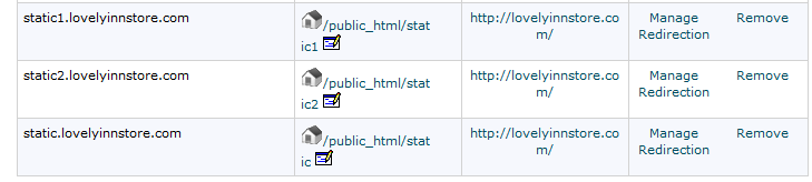

Jiten rash (away) Posted August 27, 2013 Share Posted August 27, 2013 first we will see ur site then will replace it with exact Google font. create subdomian name static1.static2,static3 then on advance parameters put does css. and images its simple to convert css to ccc just on advance parameters performance minify all Link to comment Share on other sites More sharing options...

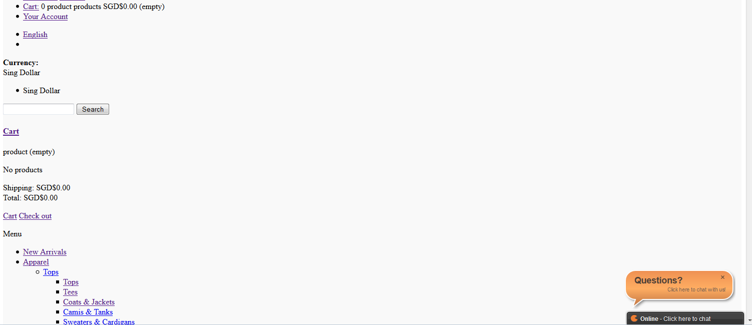

cutecat Posted August 27, 2013 Author Share Posted August 27, 2013 (edited) I have tried the CCC before and this is the output... I was using this format to do so http://www.prestasho...rs/page__st__20 also for the font, where do i change the code? I am happy to redirect the source to google to reduce the loading time. Edited August 27, 2013 by cutecat (see edit history) 1 Link to comment Share on other sites More sharing options...
