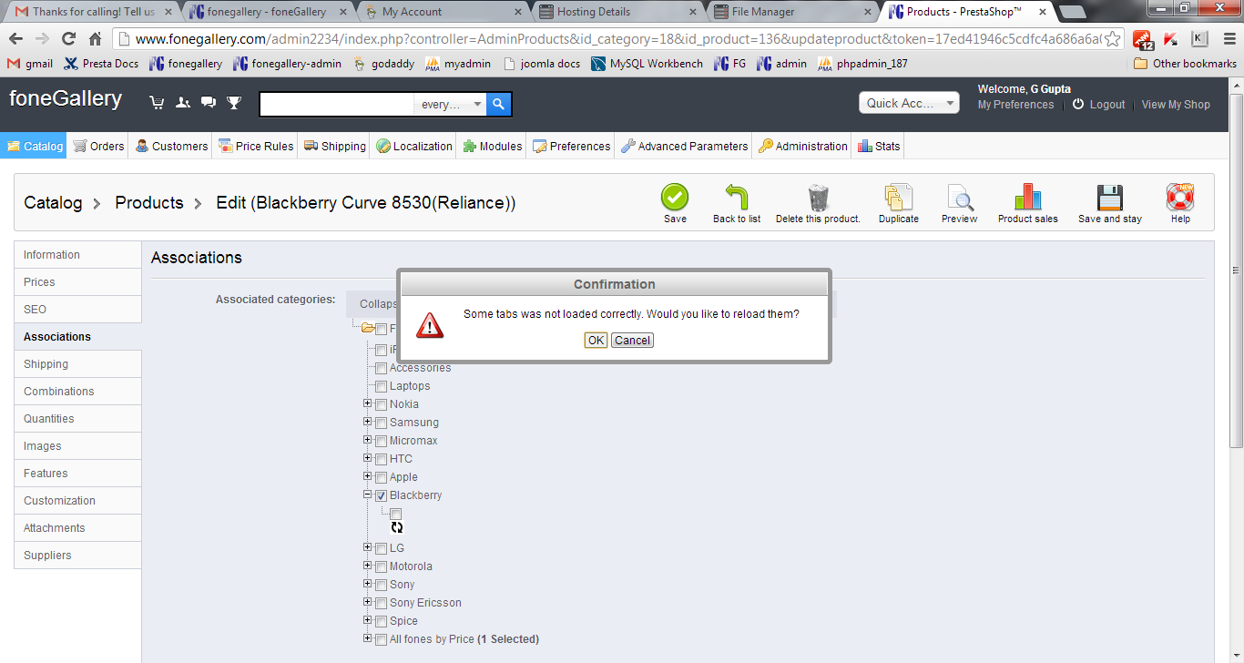

ggupta77 Posted August 17, 2013 Share Posted August 17, 2013 I am not able to use product tabs to edit product details such as price, images,features etc. I am getting an error message "Some tab were not loaded correctly, would you like to reload again?". It was working fine but from some last few days when I added products from more than 100, i am getting such type of errors. I checked the error logs also I am getting this type of error messsage every time. mod_fcgid: ap_pass_brigade failed in handle_request_ipc function Please help me out to get out of this problem. Regards Gaurav Link to comment Share on other sites More sharing options...

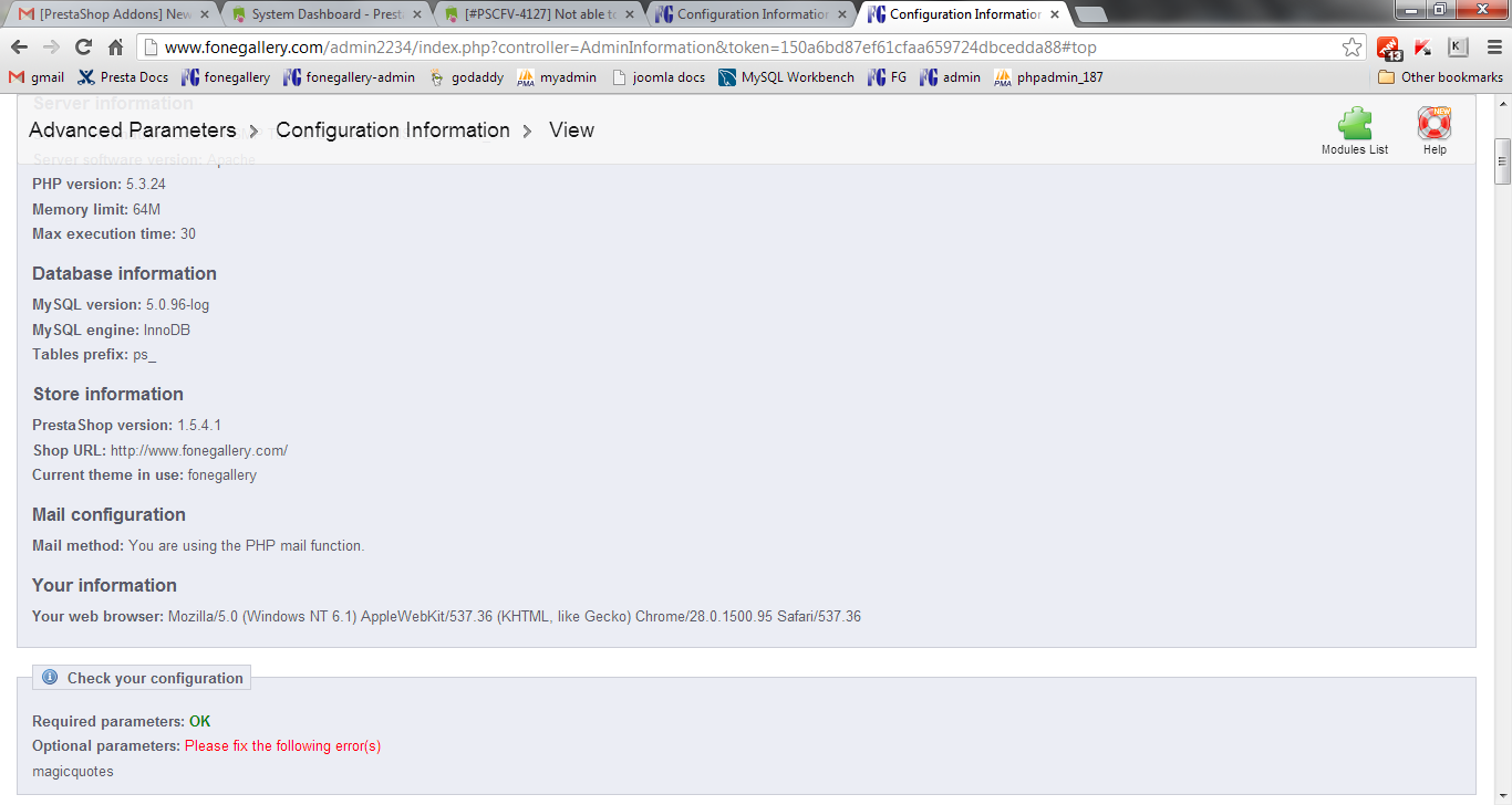

ggupta77 Posted August 17, 2013 Author Share Posted August 17, 2013 Hi I have one more concern. I was checking my configuration parameters and I found that there is some error there In optional parameters: an error message is coming Please see the attached image Link to comment Share on other sites More sharing options...
vekia Posted August 17, 2013 Share Posted August 17, 2013 everything depends on hosting where you are. moreover magic quotes php settings param is DEPRECATED in php 5.3 and REMOVED from php 5.4 it mean, that you don't have to worry. Link to comment Share on other sites More sharing options...

Maryr4277 Posted August 21, 2013 Share Posted August 21, 2013 I am having this problem too, and it just started yesterday. I have called the hosting service and they say all is going well on their end. My developer is out of town until tomorrow, and I would like to get this problem solved asap. Our front end is also running slowly. "Some tabs was not loaded correctly. Would you like to reload them" and no matter if you click OK or cancel, nothing happens. Link to comment Share on other sites More sharing options...
