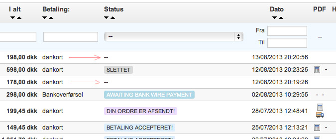

LayWay Posted August 16, 2013 Share Posted August 16, 2013 (edited) Hi I just updated from version 1.5.3.1 to 1.5.4 and when i make a order on my page, i don´t receive any order confirmation and no "you have a new order" mail. I have not changed anything but updating to the new version, and everything was working fine before. The order does not get a status like all the rest, see attached image. The order goes into my BO but does not get a status, and i think that´s why i don´t receive these 2 mail notifications. Any suggestions about this status error? Regards Thomas Edited August 16, 2013 by LayWay (see edit history) Link to comment Share on other sites More sharing options...
vekia Posted August 16, 2013 Share Posted August 16, 2013 you probably forgot about image, can you try to add it once again? Link to comment Share on other sites More sharing options...
LayWay Posted August 16, 2013 Author Share Posted August 16, 2013 Should be there now...:-) Thomas Link to comment Share on other sites More sharing options...

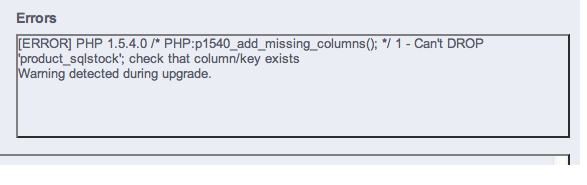

LayWay Posted August 20, 2013 Author Share Posted August 20, 2013 Yes i made a backup of everything before upgrading. I made the upgrade through the auto update module, and it gave me 1 error (see attached image). I was told by another one in this forum to ignore the error, as it was not important. Yes all new orders won't get a status or appear in the order_history in PHPmyadmin. Everything seems to look fine in my statuses and no errors anywhere. The option you refer to about the different value, is that an error only to be fixed in the code of my shop or? Thomas Link to comment Share on other sites More sharing options...
