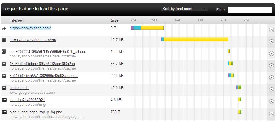

PascalVG Posted August 17, 2013 Share Posted August 17, 2013 That single moment of waiting... Official site 9 seconds, testsite 7 seconds... where does this come from! Did you see anything in phpMyAdmin, as El Patron suggested to look? Very curious where this waiting block comes from! pascal Link to comment Share on other sites More sharing options...

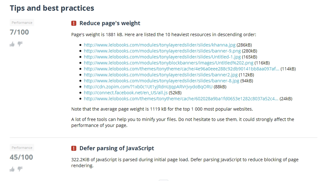

Ayush Agarwal Posted March 13, 2014 Share Posted March 13, 2014 Hi, My website link is www.lelobooks.com It is taking minimum 5+ sec to load. I have done most of the changes in the website according the rule of optimization but still facing the issues. I have a VPS server. I just need 2 second speed like other sites. Please help me out to get rid out of it. Thanks, Ayush Link to comment Share on other sites More sharing options...
HavanA Posted March 13, 2014 Share Posted March 13, 2014 As I mentioned in the other topic here, you still have some work to do: Link to comment Share on other sites More sharing options...
ricky11 Posted March 13, 2014 Share Posted March 13, 2014 (edited) HI Ayush BTW, which sites load under 2 seconds that run PRESTASHOP??? I would really like to know. Oh boy HavanaA is exactly right what are you thinking with images of more than 200kb, compress them to 50kb to 60kb! that is your problem With PS it is quite difficult to get 2 seconds loads, even with the default store on a VPS server. 5-8 seconds is about the best you can probably do with about 1000 products on default theme. You can try to disable modules, and edit he php.ini file and make all optimizations, you can also try user defer and async as mentioned in this post by others. Furthermore, you can look into he header.tpl file and look at all the unnecessary JS library calls and see which ones you do not need and delete those lines of code. If you have a lot of small images consider using sprites CDN are probably a waste of time depending on where your server is and your load. Check your theme, usually the coding is pretty bad and lots of unneeded CSS and bad html that will slow down your site. Keep your home page under 800kb if you can, 500kb would be better. Hope that helps, otherwise PS is not built for speed at this current time, BIGcommerce or Shopify stores load up in 3 seconds which is pretty good for hosted platforms, but of course you do loose a bit of the flexibility. RICKY Edited March 13, 2014 by ricky11 (see edit history) Link to comment Share on other sites More sharing options...
HavanA Posted March 13, 2014 Share Posted March 13, 2014 I also think you shoud reconsider your theme, maybe with left hand navigation and thus smaller banners. These banners are huge. You really need to reduce the weight of your page: https://www.dareboost.com/en/report/53216086e4b0c014976051a0 Maybe also consider eliminating "featured products" or "best selling products" to reduce weigt OR try to use smaller images. Do you have APC? Varnish? You may read about it here:http://blog.dh42.com/fastest-prestashop/ Link to comment Share on other sites More sharing options...
Ayush Agarwal Posted March 13, 2014 Share Posted March 13, 2014 As I mentioned in the other topic here, you still have some work to do: wwwwww.jpg Thanks mate for your information. Can you please send me the link from where you checked it. so that i can fix the maximum bugs. also please let me know when you open my website link from your end.. how much time its taking to load the different pages. Link to comment Share on other sites More sharing options...
HavanA Posted March 13, 2014 Share Posted March 13, 2014 When I load your homepage from the Netherlands on IE or Opera, it takes about 4 second for your server to respond and after about 10 seconds it is completed. Link to comment Share on other sites More sharing options...
ricky11 Posted March 13, 2014 Share Posted March 13, 2014 I.E & Chrome From Hong Kong 6 seconds for response 12 seconds for page load The slider disable it or compress all images, keep your home page under 800kb, However seems you are targeing visitors from India, where are you hosting, should also be in india itself, seems like your hosting provider may be in the US (atlinkservices.com) in Oklahoma! whaaaat???? how random is that??? host it in india boy! or use aws they have india servers. Ricky Link to comment Share on other sites More sharing options...
Ayush Agarwal Posted March 13, 2014 Share Posted March 13, 2014 I.E & Chrome From Hong Kong 6 seconds for response 12 seconds for page load The slider disable it or compress all images, keep your home page under 800kb, However seems you are targeing visitors from India, where are you hosting, should also be in india itself, seems like your hosting provider may be in the US (atlinkservices.com) in Oklahoma! whaaaat???? how random is that??? host it in india boy! or use aws they have india servers. Ricky Hi, I am little bit confuse right now.. should i move the server to indian.. or should move prestashop to other eCommerce platform like magento and all. I can do the changes in the home page but let me know is this will help in all the pages to load faster. Please tell me the best solution which i have to do first. Link to comment Share on other sites More sharing options...
Ayush Agarwal Posted March 13, 2014 Share Posted March 13, 2014 when i am checking in the pingdom.com its there is an option "performance" in which i can see Parallelize downloads across hostnames and Serve static content from a cookieless domain are null.. Can you help me regarding this. how can i set this. Link to comment Share on other sites More sharing options...

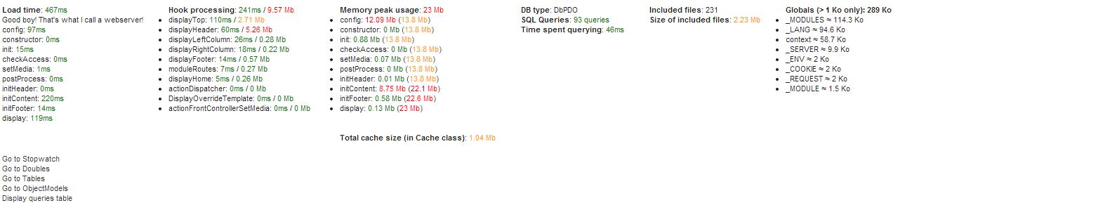

TomPuja Posted August 29, 2014 Share Posted August 29, 2014 for profiling and performance checking, PrestaShop has great little tool you may not have tried. config/defines.inc.php (set to true, test, turn off as all visitors will see this) define('_PS_DEBUG_PROFILING_', false); Hi! I have tried to set it up the way you suggested. And what should I do further? Where to look and what to assess? Tried to load a page. Doesn't feel a difference. Although when tested it with external tool pingdom.com have got a strange evaluation Your website is faster than 98% of all tested websites, which is obviously not true as the page uses more or less the same time to load and it didn't happen so before I made that change. Moreover, pingdom.com is unable to load the page now (Redirection automatique dans 5 secondes), yet using a browser it loads the way it should. Link to comment Share on other sites More sharing options...
El Patron Posted August 29, 2014 Share Posted August 29, 2014 Hi! I have tried to set it up the way you suggested. And what should I do further? Where to look and what to assess? Tried to load a page. Doesn't feel a difference. Although when tested it with external tool pingdom.com have got a strange evaluation Your website is faster than 98% of all tested websites, which is obviously not true as the page uses more or less the same time to load and it didn't happen so before I made that change. Moreover, pingdom.com is unable to load the page now (Redirection automatique dans 5 secondes), yet using a browser it loads the way it should. you may find the blog post on profiling useful http://dh42.com/blog/prestashop-debug-profiling/ as for redirect, this is because you have PrestaShop debug set to true. set to false when not debugging. Link to comment Share on other sites More sharing options...
TomPuja Posted August 29, 2014 Share Posted August 29, 2014 El Patron, Thanks for the article! I went through it and everything seems to be clear until you start looking at your own data Therefore, I attached mine and wonder if you see anything to glare? Also, I attach a snapshot of pingdom cause I do not understand why this waiting time is so LONG and what it does wait for... Please give me some more hints I am grateful for your help! Link to comment Share on other sites More sharing options...
