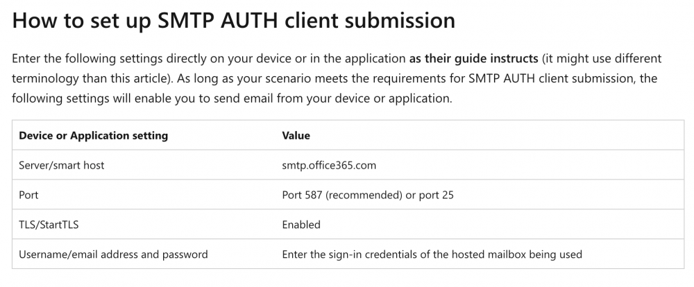

BeatsMe Posted October 22, 2023 Share Posted October 22, 2023 (edited) Sorry for digging up an old topic, but I have the same problem now.... I have just recently switched to Microsoft 365 Business email and cannot get the email working either. Have tried on a live site running ps1.6.1.24 and my test site running ps8.1.2 using the attached setting. Have contacted Microsoft support and they tell me it's not an error on their end. Did anyone find a solution to this problem?? Edited October 22, 2023 by BeatsMe (see edit history) Link to comment Share on other sites More sharing options...
