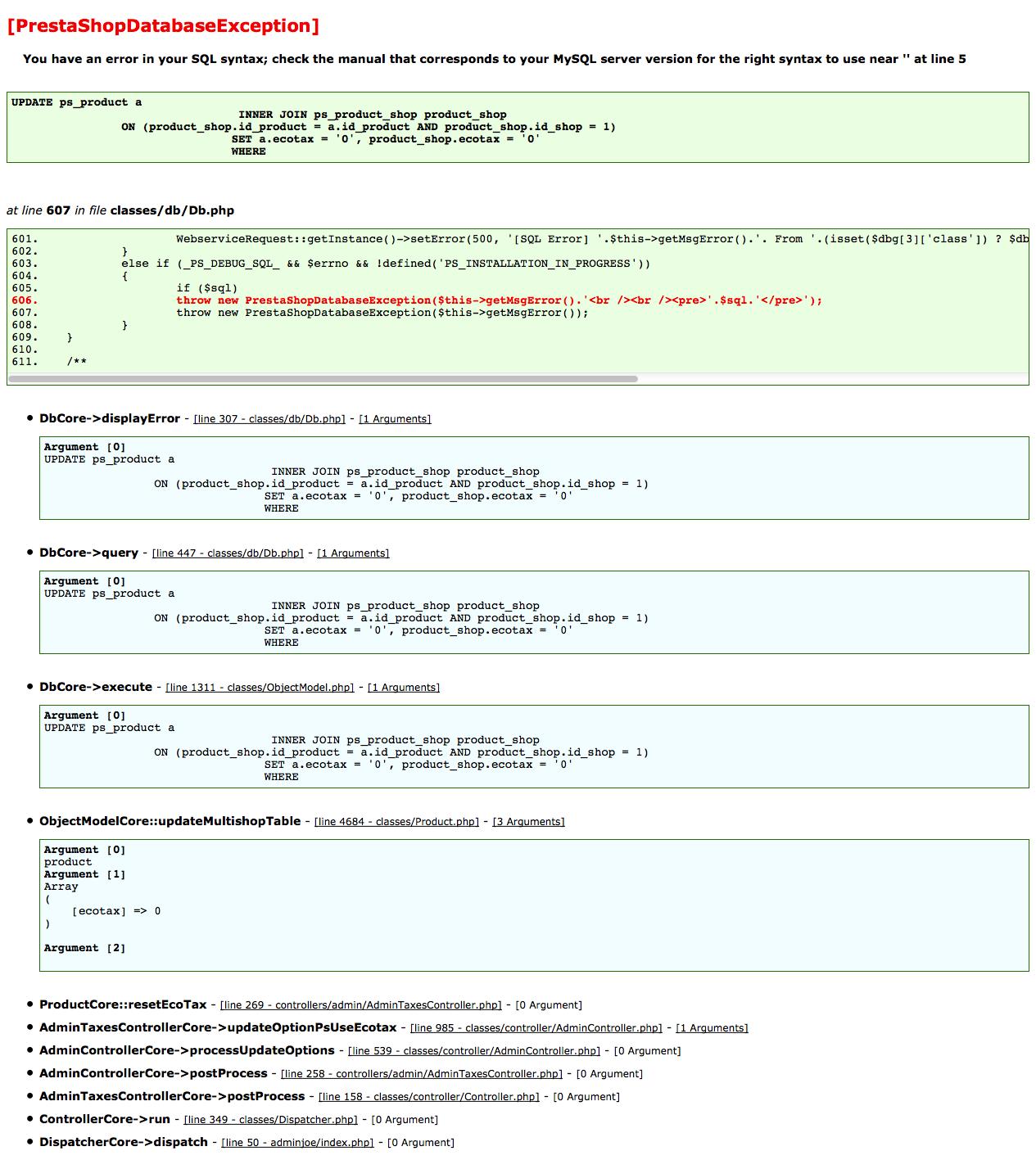

vince670 Posted August 26, 2013 Author Share Posted August 26, 2013 I've Posted 13 days ago a request for help about ecotax options not working. And was looking for answers since them in the forum and other places in the internet without a solution to my issue. I'm willing to pay for a solution to my problem. I found that most of the post about this problem don't have a reply with a solution. Is this is a bug? Here is a screenshot what I get when I try to set ecotax off. Thanks Link to comment Share on other sites More sharing options...
NemoPS Posted August 26, 2013 Share Posted August 26, 2013 That WHERE clause seems to be broken. If you're looking for paid help, you can post in the Job Offers section to receive a faster answer Link to comment Share on other sites More sharing options...
