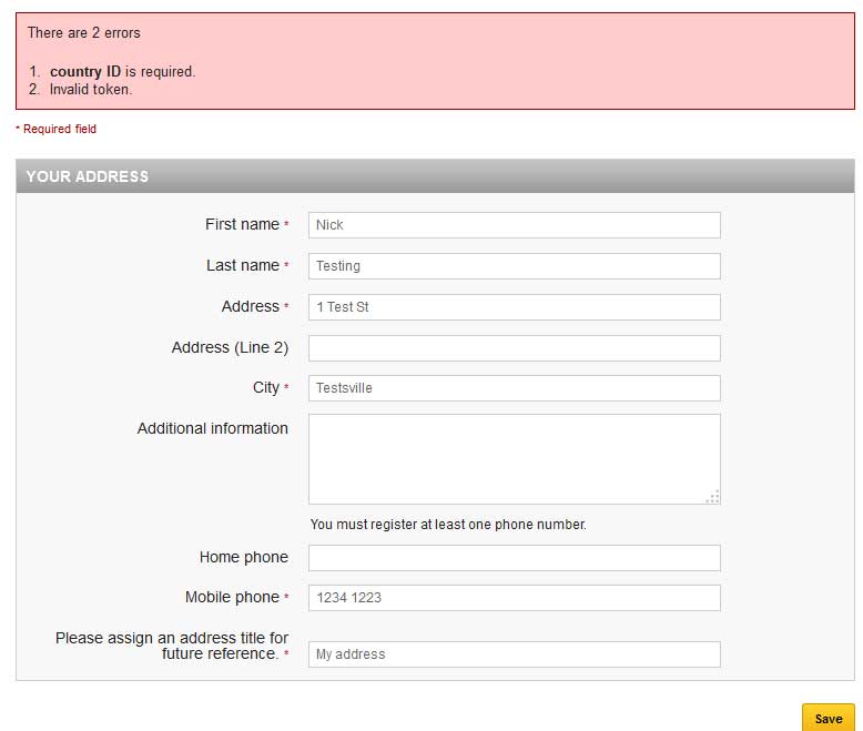

sunnyb0y Posted August 8, 2013 Share Posted August 8, 2013 (edited) Hello, I am building a PrestaShop (1.5.4) site and having trouble with step 2 of the checkout process. I cannot proceed past step 2 due to two frustrating errors: country ID is required. Invalid token. I have the same issue if I try to checkout as a guest or login and save an address. There is no Country field even in the list. And I have no idea where the token is. Nor is there a postcode field in the list. How do I get them in there? I have seen a couple of 2 year old posts with some long threads about this same issue relating to previous versions so thought I should start a new post as from the sounds of those posts, those changes will not apply to 1.5.4 - plus they are very old and I would have thought this was resolved by now. These are the fields that show up in my site: First name * Last name * Address * Address (Line 2) City * Additional information You must register at least one phone number. Home phone Mobile phone * These are the fields that show up on the PrestaShop demo site at http://demo-store.pr.../en/quick-order: First name * Last name * Company Address * City * Zip / Postal code * Country * State * Home phone * See the Zip / Postal code * and Country * fields. Have I got some setting wrong within the PS backend or is this a bug? Please help. Thanks in advance. ps Why does this not just work straight out of the box? Edited August 8, 2013 by sunnyb0y (see edit history) Link to comment Share on other sites More sharing options...
PascalVG Posted August 8, 2013 Share Posted August 8, 2013 Hi Sunny, What country to you want to sell to? The problem probably lies in the definition of the 'address' in the country you want to use. Check a few things: First check if you have defined a 'zone' to put your country in. And check if it is enabled. Then edit the country you want to send to: - Check if the country is in the wanted zone. - Select if you want to use zip/postal code - enter the format of the postal code (e.g. 4 digits, followed by 2 letters = NNNNLL (gives postal code like this: 9465KL) - Then go to the address format. You see the current format in the left block, where probably your country and postal code are missing. - go to the line where you want the country inserted (in left block). - click on country on the right. Some (green?) fields will appear, where you can select if you want the name, the zipcode format etc of a country. Click 'name'. In the left block 'Country:name' will appear. (See if it is inserted in the right place) - go to the place in the left block where you want the postal code should be inserted. Click on the right on 'address'. Some green fields about the address appear. Choose postcode.. This field will be inserted on the left. Check if the country is 'active' (i.e. shown to your customers, so they can select it.) Save. Check your checkout process again. This should help with the country/post code problem. Let me check about the token... My 2 cents, pascal 3 Link to comment Share on other sites More sharing options...

sunnyb0y Posted August 8, 2013 Author Share Posted August 8, 2013 (edited) Hi Pascal, Thank you so much for the easy to follow instructions and for taking the time to help. The zones were set up correctly (Australia) but the address format was wrong (the country and postcode was indeed missing). I updated it per your "address format" instructions and it works now - thank you very much. In fixing that, the token issue is no longer a problem either - many thanks. Edited August 8, 2013 by sunnyb0y (see edit history) Link to comment Share on other sites More sharing options...
