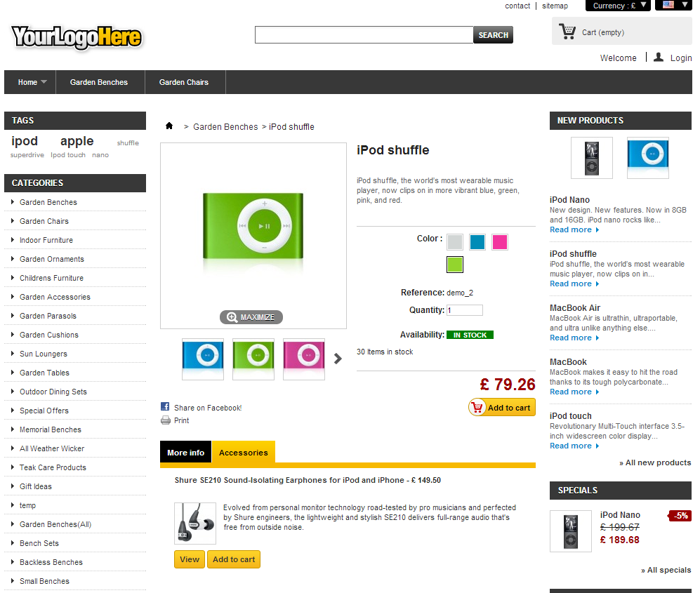

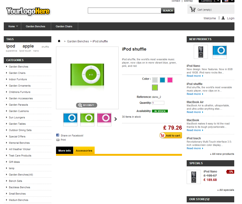

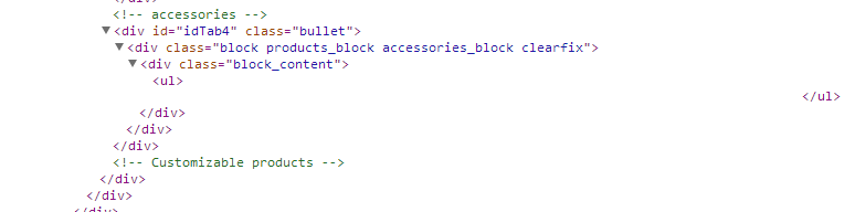

skinnybloke Posted August 8, 2013 Author Share Posted August 8, 2013 OK. This gets weirder. Yes, I have got combinations defined for products. I thought that this may be a problem with the theme I was using so I set-up a test site using the out-of-the-box theme. So first I added the earphones as an accessory to the ipod shuffle. The product displayed correctly but there was no option to alter the quantity I then added a colour combination to the earphones ... and the earphones did not display at all. There is a tab for 'Accessories' but no accessories are shown Looking at the code you can see that there are unordered list tags but nothing within it Link to comment Share on other sites More sharing options...
