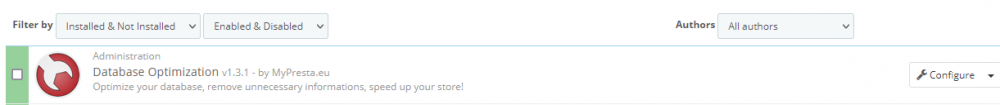

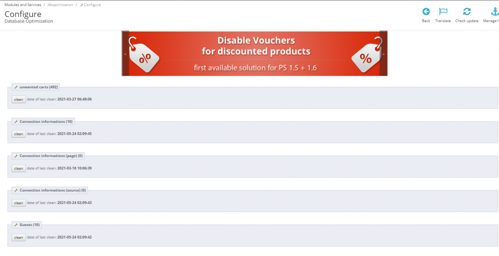

bnadauld Posted May 24, 2021 Share Posted May 24, 2021 (edited) i installed a module on both of my sites. it does the same (and more) as the sql scripts i posted earlier on this thread..... Every now and again i hit the clean buttons. I get tones of bots too. Sped the sites up - but note: you'll kill any customers checkouts so i press the clean button when i'm not anticipating many orders. !!!!Def backup your db before you install it and press any buttons!!! https://mypresta.eu/modules/administration-tools/database-optimization.html Edited May 24, 2021 by bnadauld (see edit history) Link to comment Share on other sites More sharing options...
Puppo Posted May 24, 2021 Share Posted May 24, 2021 (edited) On 5/24/2021 at 6:27 AM, bnadauld said: i installed a module on both of my sites. it does the same (and more) as the sql scripts i posted earlier on this thread..... Every now and again i hit the clean buttons. I get tones of bots too. Sped the sites up - but note: you'll kill any customers checkouts so i press the clean button when i'm not anticipating many orders. !!!!Def backup your db before you install it and press any buttons!!! https://mypresta.eu/modules/administration-tools/database-optimization.html Expand @bnadauldjust a warning from my experiences with mypresta.eu Modules: great modules but no support! If you have a problem you need a lot of luck to get a answer, most times there is no answer. So if you use a module from there you have to be ready to support your self.. I don't know what happened and why this is so. I think @vekia is the owner there and he was a really active Part in this forum but since some time he is not anymore here. We use many of his great modules but as I already said, you are alone after buying.. PS: I also offered to pay for Support... no answer.. Edit again: i checked the Profile of @Vekia and i looks like he is still logging in the forum.. Edited May 24, 2021 by Puppo (see edit history) 1 Link to comment Share on other sites More sharing options...
bnadauld Posted May 28, 2021 Share Posted May 28, 2021 On 5/24/2021 at 6:45 AM, Puppo said: @bnadauldjust a warning from my experiences with mypresta.eu Modules: great modules but no support! If you have a problem you need a lot of luck to get a answer, most times there is no answer. So if you use a module from there you have to be ready to support your self.. I don't know what happened and why this is so. I think @vekia is the owner there and he was a really active Part in this forum but since some time he is not anymore here. We use many of his great modules but as I already said, you are alone after buying.. PS: I also offered to pay for Support... no answer.. Edit again: i checked the Profile of @Vekia and i looks like he is still logging in the forum.. Expand i agree but this module really works for me - im on a shared hosting and the amount of logged bots (in _psguest) was making the sites completely unusable. hope you have the same luck Link to comment Share on other sites More sharing options...
