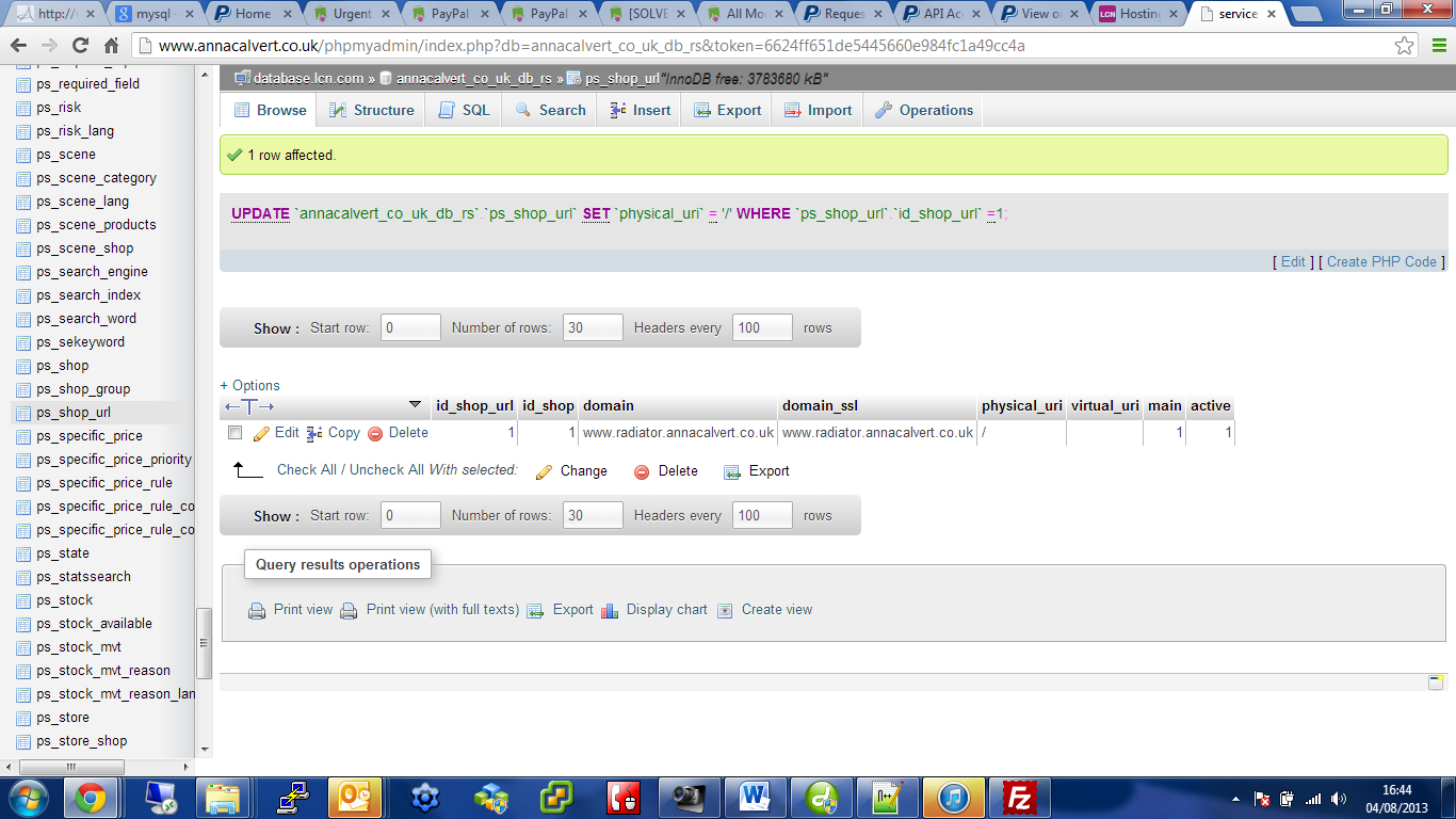

El Patron Posted August 4, 2013 Share Posted August 4, 2013 well, you didn't really answer my question, I asked if you change the UR'I' lets assume you did... You will need access to your my sql db, using phpmyadmin for example Change the table yourprefix_shop_url field physical_uri to / http://screencast.com/t/OFR0Fyn9 Link to comment Share on other sites More sharing options...

gnattle Posted August 4, 2013 Author Share Posted August 4, 2013 I have done that as per your instructions (see screen shot) and now you cannot access the site at all. Its says The website encountered an error while retrievinghttp://www.radiator..../adminscissors/. It may be down for maintenance or configured incorrectly. Link to comment Share on other sites More sharing options...
