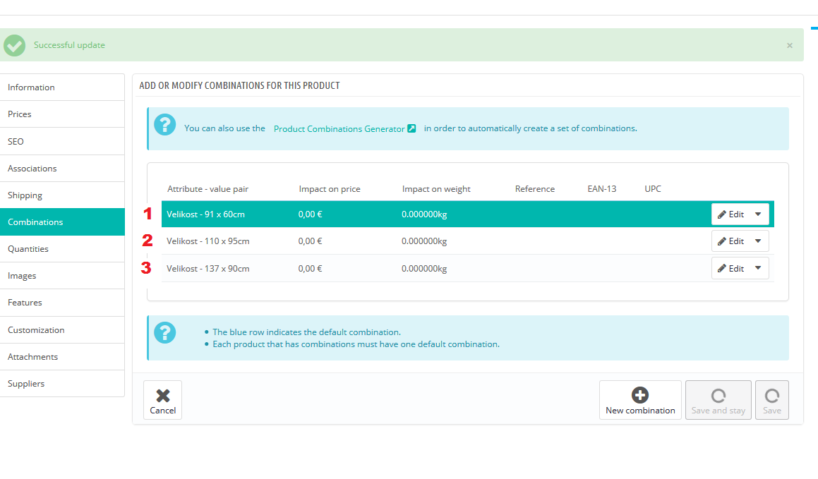

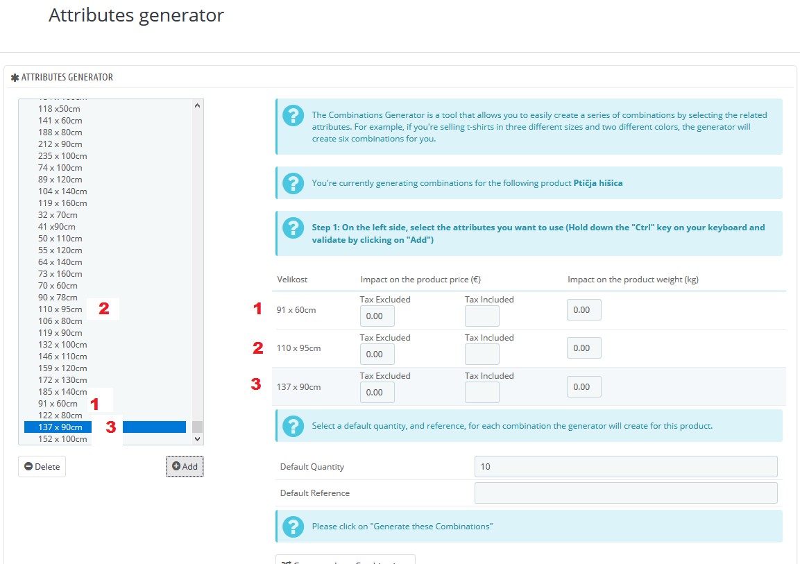

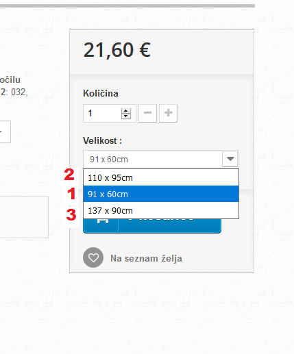

andrej981 Posted April 19, 2017 Share Posted April 19, 2017 Hi, I have a problem with sorting product attribute. In BO size is list in order that I added it with combination generator. But in front ofice attributes are not in same order like in BO. Problem is that if I choose size which I already add for product before, prestashop place ¨"old" size first and then new created size. But only in FO in BO they are just like they have to be. Examlpe: BO 100 x 100cm (add second) BO 110 x 110cm (add first) FO 110 x 110cm (add first) FO 100 x 100cm (add second) My prestashop version is 1.6.1.4. Can someone please help me with this? Link to comment Share on other sites More sharing options...
