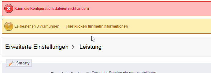

Robert Schmitt Posted July 28, 2013 Author Share Posted July 28, 2013 (edited) no, nothing.. I just tried something, I added something into the shopping cart. There I was able to use the login and this is the error messagfe which came Please see picture.. What is really strange the local version works. Robert PS: for some reason i also have magicquotes as a konfiguration error in back office.. Configuration the local verison doesn't have any issues Edited July 28, 2013 by Robert Schmitt (see edit history) Link to comment Share on other sites More sharing options...

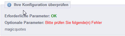

Robert Schmitt Posted July 29, 2013 Author Share Posted July 29, 2013 (edited) First, Morning Vekia.... man do you work 24/7? Thx for the swift reply !!! I have added a picture about magicquotes... Then I spoke with my provider if they made any changes they siad no... But he was able to say that in my .htaccess there is trash being writen into the file.. This morning I made a change in the back office about the magicquotes which i found on the site http://www.prestasho..._1#entry1232609 made that change saved then got 500 internal error.. then remove the .htaccess and everything was running agian. Really don't get it .. whats going on with my site... Cheers Robert Edited July 29, 2013 by Robert Schmitt (see edit history) Link to comment Share on other sites More sharing options...
vekia Posted July 29, 2013 Share Posted July 29, 2013 magic quotes is a php settings, you can turn on or turn it off in this file, settings below show how to DISABLE magic quotes (just remove the ; before the magic_quotes_gpc = Off etc.) ; Magic quotes ; ; Magic quotes for incoming GET/POST/Cookie data. magic_quotes_gpc = Off ; Magic quotes for runtime-generated data, e.g. data from SQL, from exec(), etc. magic_quotes_runtime = Off ; Use Sybase-style magic quotes (escape ' with '' instead of \'). magic_quotes_sybase = Off Link to comment Share on other sites More sharing options...
