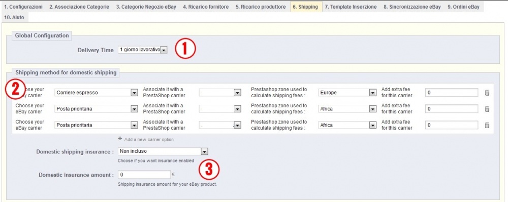

Prestalia Posted August 1, 2013 Share Posted August 1, 2013 (edited) Hello, This is not our module, our is in this image: 1 - Dispatch time 2 - eBay carrier / prestashop carrier / zone ( for every option you can configure different zone ) 3 - National insurance See you Edited August 1, 2013 by Prestalia (see edit history) Link to comment Share on other sites More sharing options...
