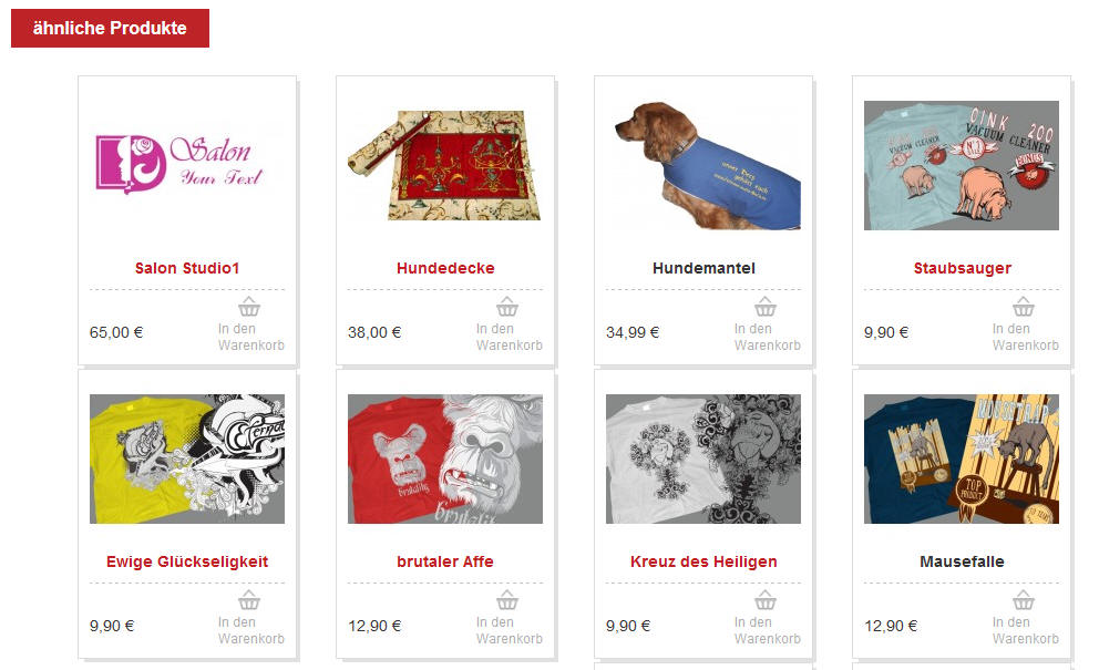

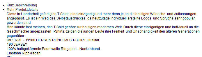

Robert Schmitt Posted July 27, 2013 Author Share Posted July 27, 2013 OK, got the shop running almost correctly.. Backend works, links works, just some small display issue and scripts not working.. Please see attachments... any tips would be greatly appreciated.. Robert Link to comment Share on other sites More sharing options...
vekia Posted July 27, 2013 Share Posted July 27, 2013 hmm i don't know where to look, coz pictures you attached looks well Link to comment Share on other sites More sharing options...

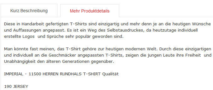

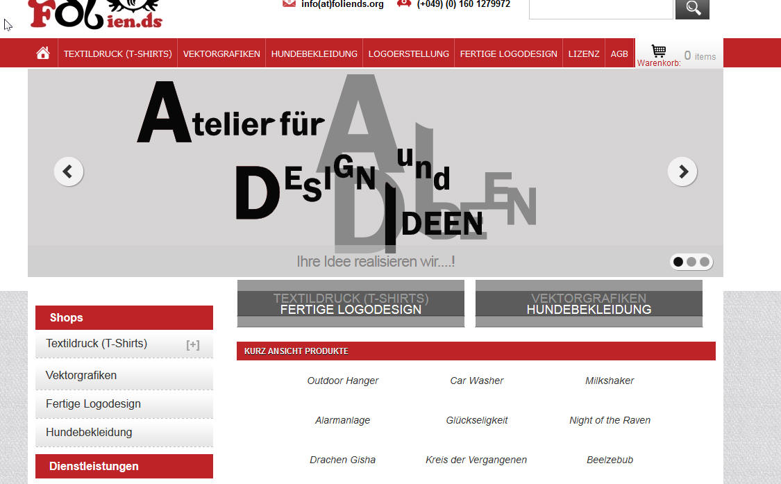

Robert Schmitt Posted July 27, 2013 Author Share Posted July 27, 2013 (edited) Hi Sir, The picture with the products is normally a slider now it just shows all products... and the other picture you normally have Tabs which are missing... here a picture of the working shop.. Robert Edited July 27, 2013 by Robert Schmitt (see edit history) Link to comment Share on other sites More sharing options...
Robert Schmitt Posted July 28, 2013 Author Share Posted July 28, 2013 Hi Vekia, did you see the difference in the picutres ? Cheers Robert Link to comment Share on other sites More sharing options...
vekia Posted July 28, 2013 Share Posted July 28, 2013 thanks now i see it looks like CSS issue turn on console in your browser, then check your localhost - you will see there errors, maybe some of the css files can't be included Link to comment Share on other sites More sharing options...
