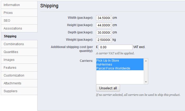

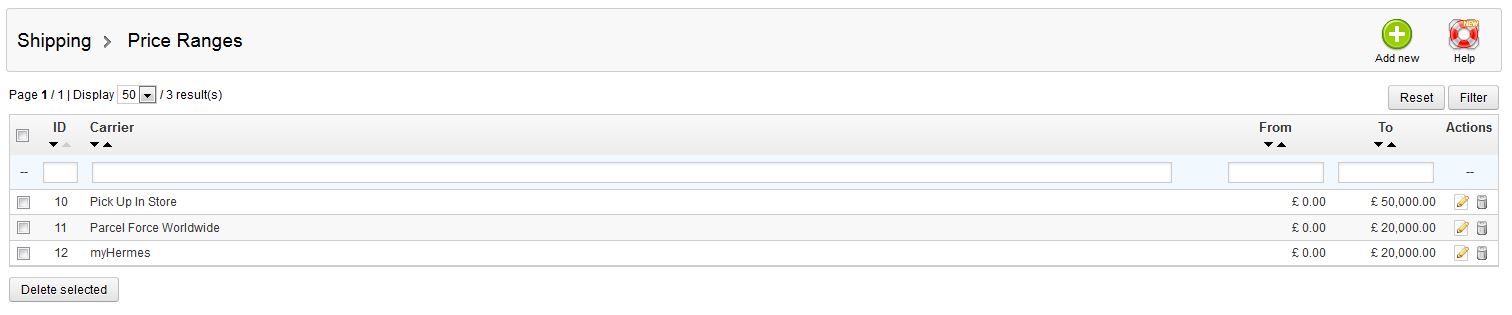

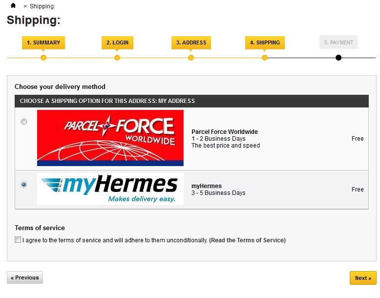

MartyW Posted July 26, 2013 Author Share Posted July 26, 2013 Hello Mimpro, Thanks for replying. Yes I added the carriers to the product. When I buy the product both carriers come up but the come up as "Free shipping" I have attached a few images Any thoughts? Link to comment Share on other sites More sharing options...

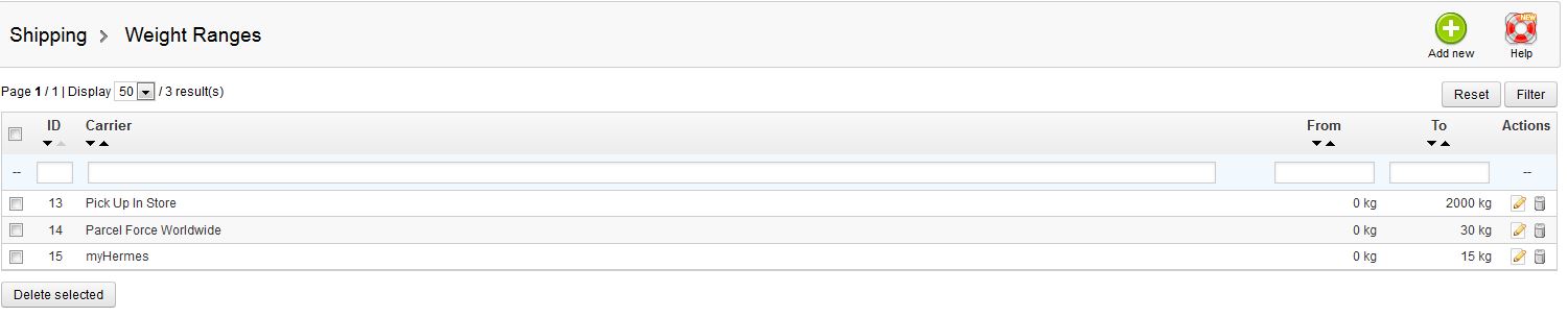

vekia Posted July 26, 2013 Share Posted July 26, 2013 1) and what about shipping configuration? Have you selected: 2) what about weight ranges? Link to comment Share on other sites More sharing options...

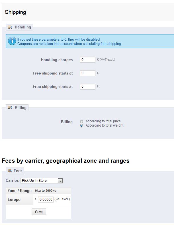

MartyW Posted July 26, 2013 Author Share Posted July 26, 2013 (edited) Yes this is what I have see attached. I think i need to say somewhere if the order weighs X Carrier A will charge the default amount of £Y Or am I thinking of prestaShop in completley the wrong way? Where do you enter shipping prices/costs for each carrier? Thanks Martyn Edited July 26, 2013 by MartyW (see edit history) Link to comment Share on other sites More sharing options...
mimpro Posted July 26, 2013 Share Posted July 26, 2013 (edited) Obviously you haven't set anything yet at weight ranges. .. for each carrier.. that is 0kg--1kg (so you can put how much charge for this range later) 1kg--2kg (so you can put how much charge for this range later) 2kg--5kg (so you can put how much charge for this range later) 5kg--10kg (so you can put how much charge for this range later.... and so on.) there is a tutorial on how to do this i'll try to find the links for you. But somehow you can google such as 'setting price range prestashop'.. ------ Oh i see it. it's a wrong configuration in your weight ranges. Edited July 26, 2013 by mimpro (see edit history) Link to comment Share on other sites More sharing options...

mimpro Posted July 26, 2013 Share Posted July 26, 2013 So it is quite detail settings there if want to learn. But after you understand it, it is a relief. I'll try to make it a brief here: if you want to set delivery charge based on total item weight.. 1- make sure all of your product have specified the unit weight there each. 2- in Shipping->Carriers - set a Carrier with appropriate details - make sure you assigned the correct zone for that carrier services - at the billings --> set to 'according to total weight - and you would rather consider the out-of-range behavior (you will understand at later - skip first) 3. in Shipping->Weight Ranges (in this case, your rules in your first post here) - add new ---> select the specific carrier from the dropdown ---> and fill from : 0 to 1 (kg or whatever weight unit) ----> save - add new ---> select the specific carrier from the dropdown ---> and fill from : 1 to 2 ----> save - add new ---> select the specific carrier from the dropdown ---> and fill from : 2 to 5 ----> save - add new ---> select the specific carrier from the dropdown ---> and fill from : 5 to 10 ----> save - you may stop here or you want to continue until you satisfy. 4. in Shipping->Shipping - go to last section: Fees by carrier, geographical zone and ranges. - select the specific carrier from the drop down list - you will clearly see the matrix table based on your zone selected VS weight range you defined previously. - fill in the blanks with your rate. - note: default values each will be 0.00, and you have to fill your value, and if you don't have any value to put, don't let it 0.00. Delete it, make it blank and your cart knows it isn't apply for that particular matrix. if you leave it 0.00, it is considered free shipping. if it is blank, it is not available. 5. remember the out-of-range behavior? So you see your matrix now and ask what happens if total weight is more than max values in this table? So go to Shipping->Carriers and find the out-of range behaviour. You decide what to do from the list 6. If you have any other carrier.. repeat all from step 2-->5. Make sure each step you do select correctly the carrier. Well, I hope this brief is good enough for you to start. You may explore the rest later. . 2 Link to comment Share on other sites More sharing options...
MartyW Posted July 27, 2013 Author Share Posted July 27, 2013 Thanks for that I didnt realise you had to fill out the prices on the "SHIPPING" page as per the courier selected from the drop down list. I have another question surrounding shipping that I hope you can help with I have searched google and found nothing apart from this http://www.prestashop.com/forums/topic/109579-how-to-set-shipping-cost-for-additional-items-in-prestashop-using-usps/ If a customers buys 2 items that individually are below my couriers weight and volume restrictions but together are over the volume restrictions I will have to send 2 parcels and I need to charge an additional fee for this. How do I reflect this in the shipping settings? There is an "Additional shipping cost (per quantity):" but this setting adds it to all items 1st, 2nd 3rd etc but Im looking for a setting that will add a shipping cost to the 2nd, 3rd, 4th, item only does such a setting exist. The only other way I can get around this is to base the courier charges on the price. Any help on this would be great Marty Link to comment Share on other sites More sharing options...

MartyW Posted July 28, 2013 Author Share Posted July 28, 2013 (edited) Hey everyone, I get how the weight settings work i.e. for an order below X kg's the price is Y but the problem I am having is when a customer buys 2 bulky items the total weight stays below the threshold of 30kg (My couriers limit per parcel) but when the size of the parcel goes above the volumetric cm3 size per parcel I have to send 2 parcels. This is a question on cm3 volume not weight kg. Can I set an additional cost per order should an order go beyond a certain size (volume cm3 wise) I can see that prestaShop allows you to enter the package size of each item. Is there a setting for additional volume? I am sure the PrestaShop developers have thought about this topic and I have seen other similar posts that have been left unresolved am I just missing somthing in the back office? To me and my BASIC programming skills the PrestaShop developers could implement this with a simple if, if else statement in the prestaShop programming i.e. in the back office there would be a box similar to - "Additional shipping cost (per quantity):" but it would be called somthing like - Additional shipping cost (per additional item): +2,+3, +4 etc users would enter the additionalItemShippingCost in the back office "perAdditionalItem" box; and within the PrestaShop code an ifStatement like this would be implemented //Adding additional items by volume setting up a +2 cost int x = itemQuantity; double y = additionalItemShippingCost; //if the item count is equal to 2 if (x == 2){ // then increment default cost for y/additionalItemShippingCost y+1; } //nested if statment if (x == 3){ // then increment default cost for y/additionalItemShippingCost y+2; } //+3, +4, +4 etc //else if else if (x <2){ //do nothing } or using boolean's i.e. itemQuatity = 2 (True) AdditionalItemCost+; There are more efficient ways to program this (ArrayList for example) but the above is as far as my programming skills go Best regards and thanks for any the help on this topic Marty Edited July 28, 2013 by MartyW (see edit history) Link to comment Share on other sites More sharing options...
mimpro Posted July 28, 2013 Share Posted July 28, 2013 (edited) Wow.. may I know what are you selling? Sounds like big things here. Well frankly i don't know about dimension limits of a certain carrier. I never have to do this for my clients before. But in your case, there is a setting here in carrier: which are referred from each product detail form: -------------------------- i don't know about this since never experience it yet. But this is opportunity to learn here. Have you go through the dimension limit settings on that particular sections above? Then after testing what results you get? I am interested to know more especially in your case here. .. and for the coding part, that actually can be done. But then this is customized to your shop. you might hightlight those to the rest of developers here, maybe your suggestion is useful for the next development. Cheers. Edited July 28, 2013 by mimpro (see edit history) Link to comment Share on other sites More sharing options...
