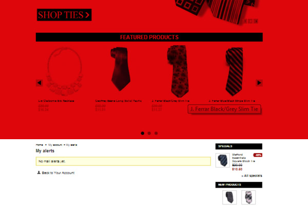

JANDSCLOTHINGCO Posted July 26, 2013 Share Posted July 26, 2013 (edited) Having an issue with the top modules showing up on a couple of pages and not sure what files I would need to edit to remove them from the pages. There is no option in the BO to hide them from the pages. Anybody know which file I would need to edit to have them not show up on these pages? I noticed it only happens on pages that point to /module/*/* on the site Edited July 28, 2013 by JANDSCLOTHINGCO (see edit history) Link to comment Share on other sites More sharing options...

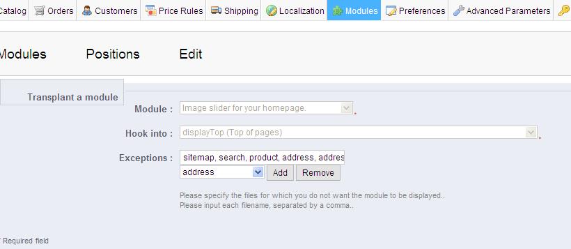

vekia Posted July 26, 2013 Share Posted July 26, 2013 you can define exceptions for module in the modules > positions just search for "displayTop" list and you will be able to manage modules added to the "top" section then, click on "edit" button near the module you want to disable and define exceptions Link to comment Share on other sites More sharing options...
JANDSCLOTHINGCO Posted July 26, 2013 Author Share Posted July 26, 2013 @vekia I already have the top modules disabled for every page possible through the BO. However they still display on certain pages where a module is involved. (ie. my alerts and cash on delivery) The site is www.jandsclothingco.com and using prestashop 1.5.4.1 and you can use test account to get to the my alerts page email: [email protected] pass: test1234 Link to comment Share on other sites More sharing options...
JANDSCLOTHINGCO Posted July 28, 2013 Author Share Posted July 28, 2013 Ok figured it out. I didn't know that I could manually type the name of the adress into the exceptions and only thought I could use the options from the dropdown list. Had to manually type "account" into the exception list to hide them on the my alerts page Link to comment Share on other sites More sharing options...
JackTheRipper Posted August 7, 2013 Share Posted August 7, 2013 (edited) (SOLVED) Hello i added some 'exceptions' for slide. How can i remove this exceptions ? Edited August 7, 2013 by JackTheRipper (see edit history) Link to comment Share on other sites More sharing options...
vekia Posted August 7, 2013 Share Posted August 7, 2013 you can remove them from the website where you defined it, just empty the box with exceptions (or remove certain items form the box) Link to comment Share on other sites More sharing options...
