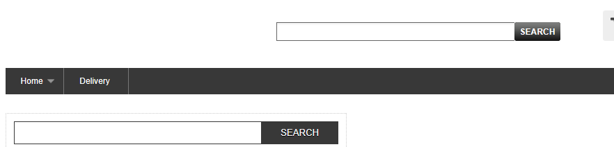

Hiroshi Nagura Posted July 24, 2013 Share Posted July 24, 2013 Hi. I am new to use Presta. Today, suddenly a new search box came up below the horizontal menu. The original search box can be deleted by Quick Search Block, but the new coming one can not. It is appreciated if someone tells me how to delete the new search box. Thank you. Hiro Link to comment Share on other sites More sharing options...

vekia Posted July 24, 2013 Share Posted July 24, 2013 it looks like "prediggo" search module, have you got it ? 1 Link to comment Share on other sites More sharing options...
Hiroshi Nagura Posted July 24, 2013 Author Share Posted July 24, 2013 Wow. I unistalled Prediggo and the search box disappeared. Thank you very much for your kind support! Hiro Link to comment Share on other sites More sharing options...
