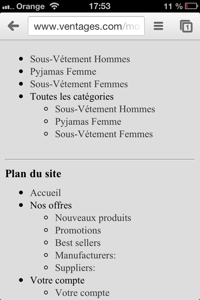

Rymoucha Posted July 30, 2013 Share Posted July 30, 2013 Here is a pic of the mobile version Link to comment Share on other sites More sharing options...
vekia Posted July 30, 2013 Share Posted July 30, 2013 weird this is how it looks for me: Link to comment Share on other sites More sharing options...
Rymoucha Posted July 30, 2013 Share Posted July 30, 2013 Yes same thing for me! I gave a shot after authentification Link to comment Share on other sites More sharing options...
Rymoucha Posted July 30, 2013 Share Posted July 30, 2013 as you can see! jquery mobile is not functional! Link to comment Share on other sites More sharing options...
