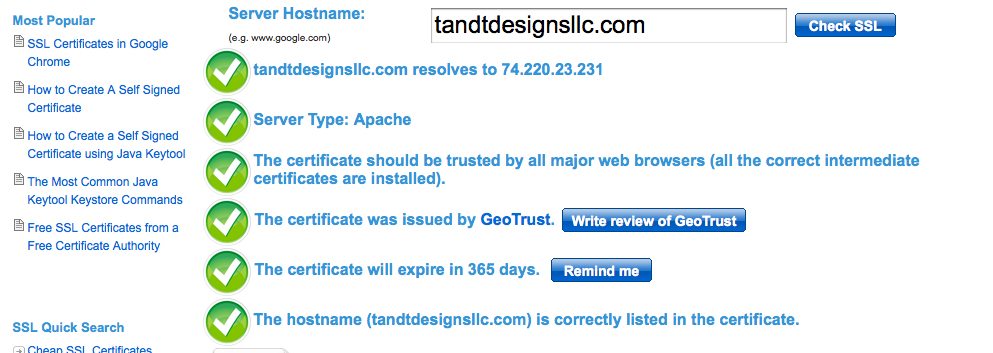

treasuresangel Posted July 18, 2013 Share Posted July 18, 2013 (edited) I have an issue with our SSL certificate. It is installed correctly-see image. I went to Preferences>General and checked Enable SSL. Also clicked on link above that to install. It now says "settings updated correctly". If I go to checkout, I get a 404 page. I have short (friendly links) enabled and the .htaccess RewriteEngine on Also, it means that Paypal doesn't get to show up as an option, so no one can buy and this is a live store. Any ideas? thanks. Edited July 19, 2013 by vekia (see edit history) Link to comment Share on other sites More sharing options...
benjamin utterback Posted July 18, 2013 Share Posted July 18, 2013 Hi treasureangel, you need to contact your hosting provider because there are times that the SSL will conflict with friendly URL and your hosting provider will need to change some settings. Only they would know. Another thing you might try is to make a backup of your files and database and then force the regeneration of the htaccess by toggling on and off the Friendly URL option. If you do this, please make sure to have a working backup. Link to comment Share on other sites More sharing options...
