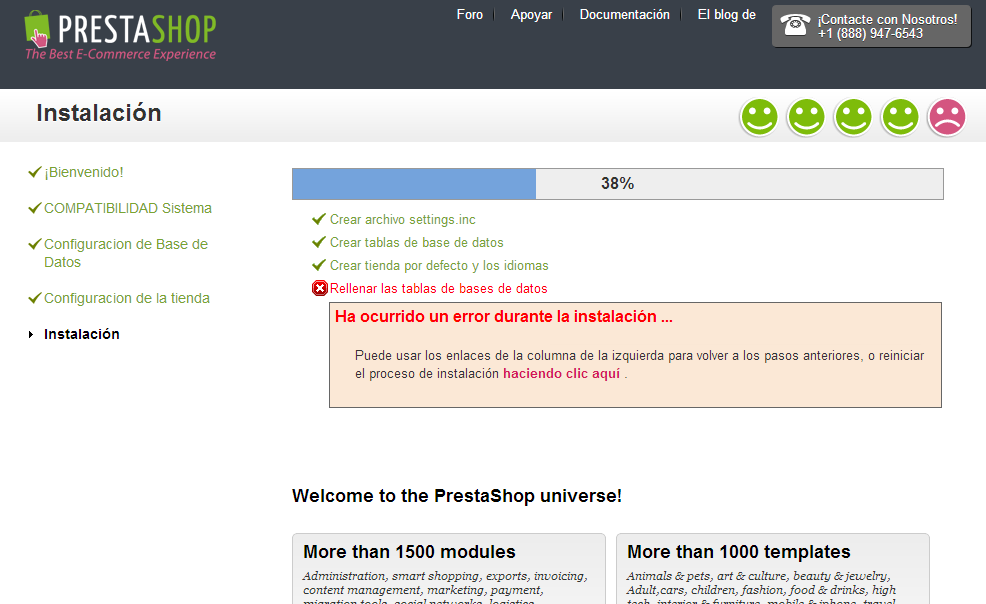

kdulcey Posted July 18, 2013 Share Posted July 18, 2013 no pasa del 38 % la instalacion ya le combie los permisos cree nuevas bases de datos y nada Link to comment Share on other sites More sharing options...
OlivierJM Posted July 18, 2013 Share Posted July 18, 2013 no pasa del 38 % la instalacion ya le combie los permisos cree nuevas bases de datos y nada Echale un OjO a este post: http://www.prestashop.com/forums/topic/258501-evitar-fatal-error-uncaught-exception-smartycompilerexception-with-message-syntax-error-in-templ/page__p__1287796#entry1287796 Link to comment Share on other sites More sharing options...
