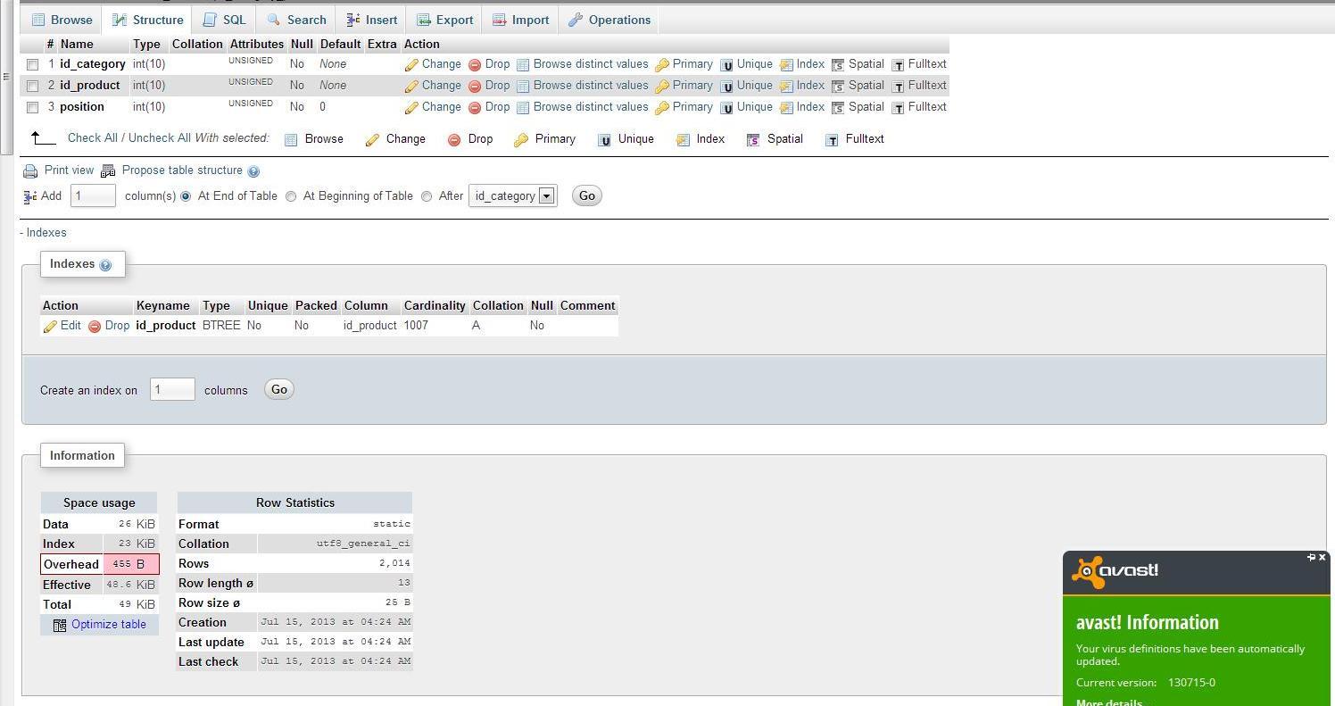

phantomeye Posted July 15, 2013 Author Share Posted July 15, 2013 (edited) Hi Bellini13, Thanks for your answer, this is what i found, let me know what you think. Cheers ! Edited July 15, 2013 by phantomeye (see edit history) Link to comment Share on other sites More sharing options...
bellini13 Posted July 15, 2013 Share Posted July 15, 2013 Oh, the entire command failed. Ok, glad we checked. Using phpmyadmin, execute this command which will add the missing primary key. Just click on the SQL tab for the ps_category_product table. Then paste the below command and click go. ALTER TABLE `ps_category_product` ADD PRIMARY KEY (`id_category`, `id_product`) Then confirm the primary key exists using the commands in the above post. Link to comment Share on other sites More sharing options...

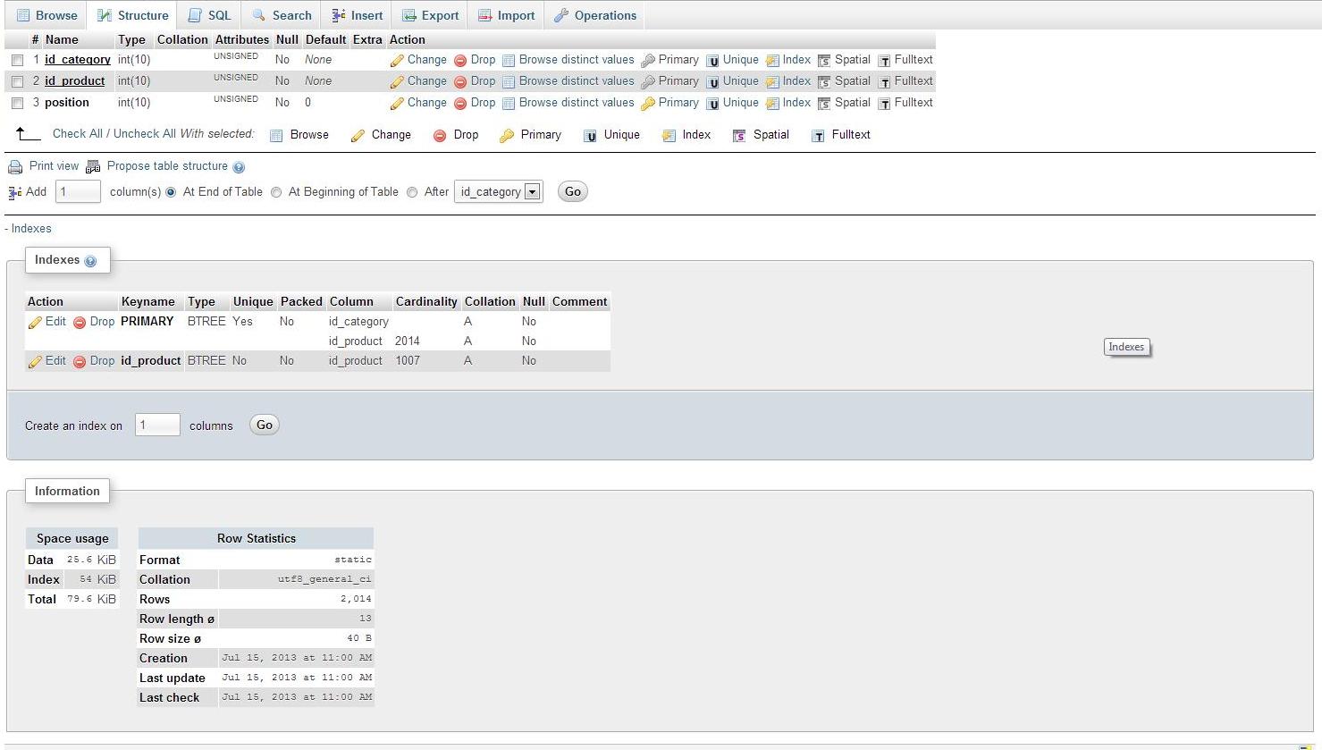

phantomeye Posted July 15, 2013 Author Share Posted July 15, 2013 Just updated the table and here is what it looks like now. Did this table manage all the default category and category information ? Link to comment Share on other sites More sharing options...
bellini13 Posted July 15, 2013 Share Posted July 15, 2013 this table simply manages what products exist in which categories, and in which order they would appear by default. the products default category is stored within the product table. Link to comment Share on other sites More sharing options...
