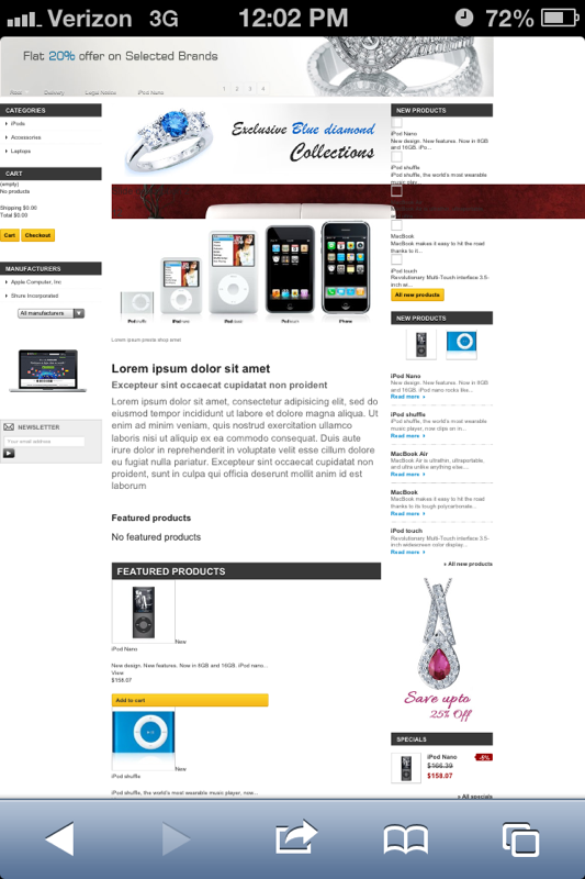

Made4greatness Posted July 10, 2013 Share Posted July 10, 2013 I recently purchased a website and I am very new to pretashop and webdesign. I started exploring the site and found themes online and added them. I noticed that once I changed the theme, some part of the old them would still be on there and no the site, is full of different themes and looks horrible. How can I fix this? How this this happen? and How can I prevent this from happening again, PLEASE HELP!!! ATTACHED IS A PHOTO OF MY SITE NOW Link to comment Share on other sites More sharing options...

vekia Posted July 11, 2013 Share Posted July 11, 2013 i checked your website well i think that now you have to customize it only. move to the modules > Positions searh for block cart module and remove it from displayTop section click on transplant button and select this module and add it for example, to the right column. Then back to the modules > position list, search for rightColumn modules list and move the block cart module to the top of the list. another modules also need a little customization (position change) after that everything should works well. Link to comment Share on other sites More sharing options...

vekia Posted July 12, 2013 Share Posted July 12, 2013 open the modules > positions tab (not modules only) you've got there all available "places" where the modules appear. search for "displayTop" list of modules, you've got there all modules attached to the top section of your theme (where the search, cart appears now). you can remove / change positions of modules there. Link to comment Share on other sites More sharing options...
Made4greatness Posted July 14, 2013 Author Share Posted July 14, 2013 Thanks it has seemed to work. The only problem I have now is the Ipod (Along with pictures) section at the front of the site. How can I get rid of that? Link to comment Share on other sites More sharing options...
