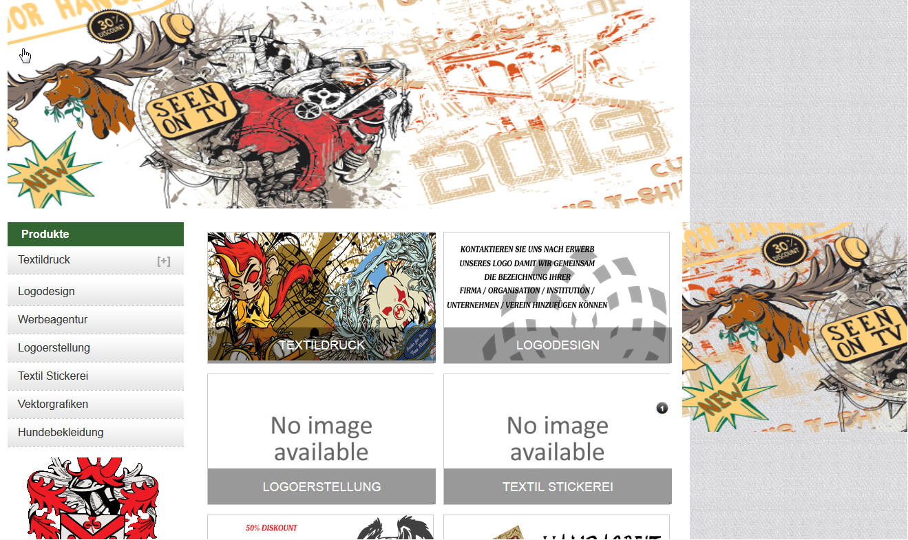

Robert Schmitt Posted July 6, 2013 Share Posted July 6, 2013 Hi folks, was hoping to get some help fixing the position of the slideshow banner, please view site. www.foliends.org This way you can better understand the problem. When i add the catagories to the main page the banner slideshow if moved to the far right outside my layout.. The problem is i have no idea how to move the catagories below the banner.. Please would really be cool if i could get some help.. Cheers Robert Link to comment Share on other sites More sharing options...

Robert Schmitt Posted July 6, 2013 Author Share Posted July 6, 2013 (edited) Hi.. Just used Live edit worked to move the Banner slide show.. but now the picuters are all mixed up into each other and overlapping any suggestions? Thx Robert Edited July 7, 2013 by Robert Schmitt (see edit history) Link to comment Share on other sites More sharing options...

Robert Schmitt Posted July 11, 2013 Author Share Posted July 11, 2013 (edited) Hi, Sorry for the delayed response... No, the I still have the issue I turned the banner off...(Slide Show) Couldn't find the solution but have to admit I'm not a programmer.. Looks Like i have to make changes in the code just don't now where and how. Still would be great to get help on this issue I can turn the banner on again ? Cheers Robert Edited July 11, 2013 by Robert Schmitt (see edit history) Link to comment Share on other sites More sharing options...

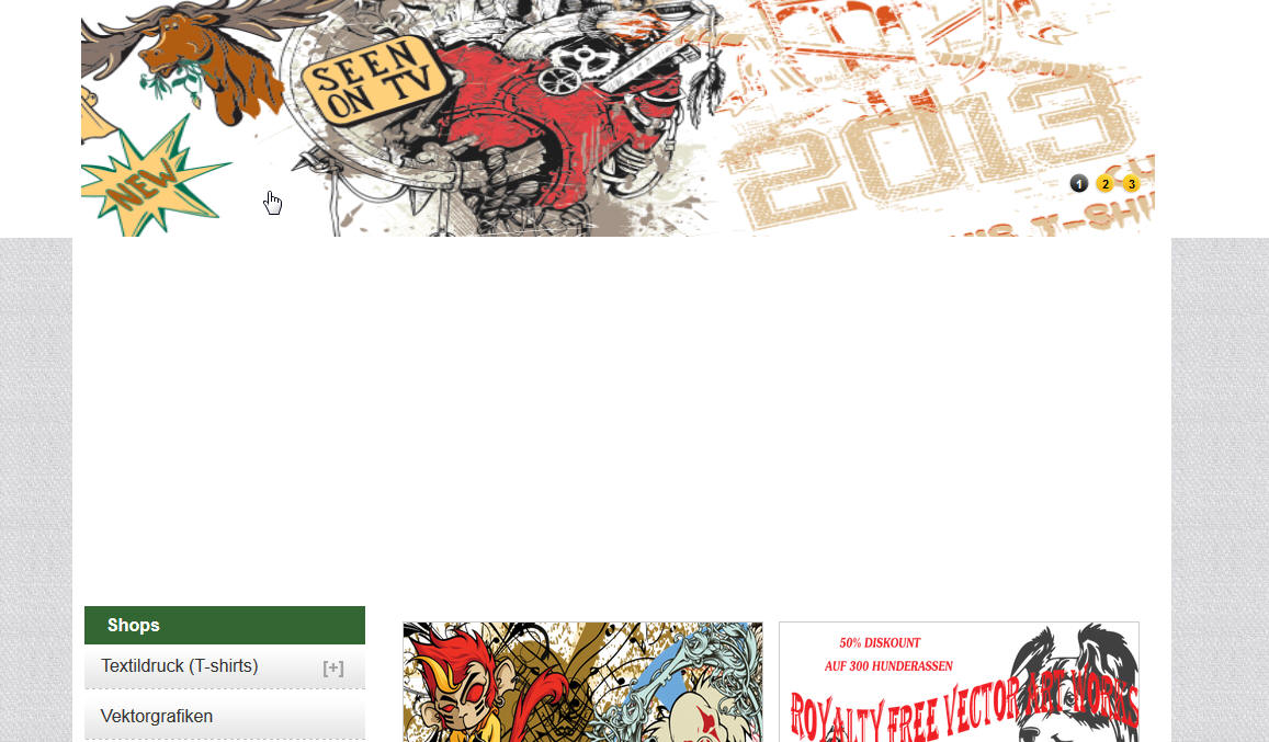

vekia Posted July 11, 2013 Share Posted July 11, 2013 this is how your website looks for me: as you can see, there is everything ok. what kind of OS / browser you use? im trying to reproduce the issue but i cant, everything works well :| Link to comment Share on other sites More sharing options...
Robert Schmitt Posted July 11, 2013 Author Share Posted July 11, 2013 (edited) Hi Vekia, No, i would like to see the slide show where the banner is sitting and make sure the pictures are not overlapping.. Cheers Robert Edited July 11, 2013 by Robert Schmitt (see edit history) Link to comment Share on other sites More sharing options...

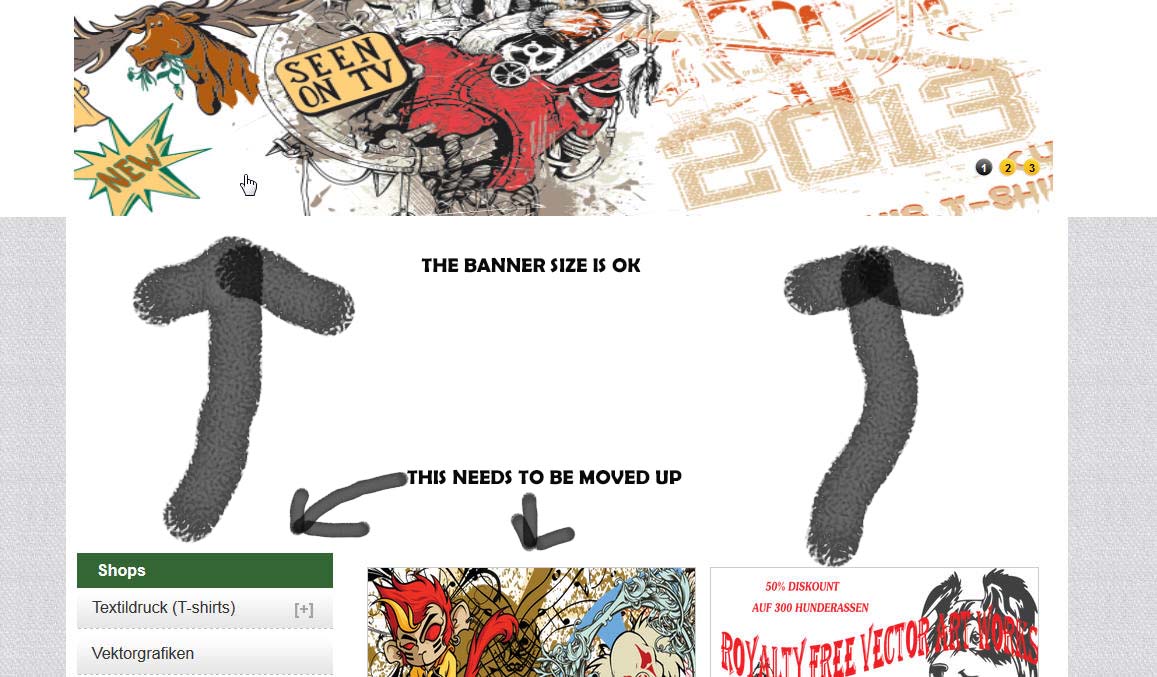

vekia Posted July 11, 2013 Share Posted July 11, 2013 sorry to misunderstanding, i don't quite understand what you expect this is what you want?: Link to comment Share on other sites More sharing options...
Robert Schmitt Posted July 11, 2013 Author Share Posted July 11, 2013 Yes, with live edit it won't work... Cheers Robert can't i make a new hook to move it above ? hmm it is a hook already on home page well you could place a hook banneronhomepage if it would work Link to comment Share on other sites More sharing options...
Robert Schmitt Posted July 11, 2013 Author Share Posted July 11, 2013 hmm that does work it was already place in banneronhome thats why i couldn't add it agian Link to comment Share on other sites More sharing options...
vekia Posted July 11, 2013 Share Posted July 11, 2013 its because this module by default don't support this hook. you have to change it: http://mypresta.eu/en/art/tips-and-tricks/how-to-move-image-slider-module-from-home-to-top-in-prestashop.html or download changed version: http://www.prestashop.com/forums/topic/256941-module-prestashop-homeslider-on-top-free-modification/ Link to comment Share on other sites More sharing options...
Robert Schmitt Posted July 11, 2013 Author Share Posted July 11, 2013 (edited) hey, your the best!!! Just have a small issue ....left over ....a big hole in the layout .. can you advice me how to remove it Edited July 11, 2013 by Robert Schmitt (see edit history) Link to comment Share on other sites More sharing options...
vekia Posted July 11, 2013 Share Posted July 11, 2013 it's because you still have got there banner div: take a look: + configure height in the module configuration page Link to comment Share on other sites More sharing options...
Robert Schmitt Posted July 11, 2013 Author Share Posted July 11, 2013 Ok, but which module please? Link to comment Share on other sites More sharing options...
vekia Posted July 11, 2013 Share Posted July 11, 2013 homeslider module has got configuration page, there you can define the height of the slider. Use the height exactly the same as your slides (images) height. Link to comment Share on other sites More sharing options...

vekia Posted July 11, 2013 Share Posted July 11, 2013 okay, everything is clear can you show me the contents of the http://foliends.org/themes/foliends/header.tpl file? Link to comment Share on other sites More sharing options...
Robert Schmitt Posted July 11, 2013 Author Share Posted July 11, 2013 (edited) hope this is the right one... {* * 2007-2013 PrestaShop * * NOTICE OF LICENSE * * This source file is subject to the Academic Free License (AFL 3.0) * that is bundled with this package in the file LICENSE.txt. * It is also available through the world-wide-web at this URL: * http://opensource.or...ses/afl-3.0.php * If you did not receive a copy of the license and are unable to * obtain it through the world-wide-web, please send an email * to [email protected] so we can send you a copy immediately. * * DISCLAIMER * * Do not edit or add to this file if you wish to upgrade PrestaShop to newer * versions in the future. If you wish to customize PrestaShop for your * needs please refer to http://www.prestashop.com for more information. * * @author PrestaShop SA <[email protected]> * @copyright 2007-2013 PrestaShop SA * @license http://opensource.or...ses/afl-3.0.php Academic Free License (AFL 3.0) * International Registered Trademark & Property of PrestaShop SA *} <!DOCTYPE html PUBLIC "-//W3C//DTD XHTML 1.1//EN" "http://www.w3.org/TR/xhtml11/DTD/xhtml11.dtd"> <!--[if lt IE 7]> <html class="no-js lt-ie9 lt-ie8 lt-ie7 lt-ie6 " lang="en"> <![endif]--> <!--[if IE 7]> <html class="no-js lt-ie9 lt-ie8 ie7" lang="en"> <![endif]--> <!--[if IE 8]> <html class="no-js lt-ie9 ie8" lang="en"> <![endif]--> <!--[if gt IE 8]> <html lang="fr" class="no-js ie9" lang="en"> <![endif]--> <html xmlns="http://www.w3.org/1999/xhtml" xml:lang="{$lang_iso}"> <head> <title>{$meta_title|escape:'htmlall':'UTF-8'}</title> {if isset($meta_description) AND $meta_description} <meta name="description" content="{$meta_description|escape:html:'UTF-8'}" /> {/if} {if isset($meta_keywords) AND $meta_keywords} <meta name="keywords" content="{$meta_keywords|escape:html:'UTF-8'}" /> {/if} <meta http-equiv="Content-Type" content="application/xhtml+xml; charset=utf-8" /> <meta http-equiv="content-language" content="{$meta_language}" /> <meta name="generator" content="PrestaShop" /> <meta name="robots" content="{if isset($nobots)}no{/if}index,{if isset($nofollow) && $nofollow}no{/if}follow" /> <link rel="icon" type="image/vnd.microsoft.icon" href="{$favicon_url}?{$img_update_time}" /> <link rel="shortcut icon" type="image/x-icon" href="{$favicon_url}?{$img_update_time}" /> <script type="text/javascript"> var baseDir = '{$content_dir}'; var baseUri = '{$base_uri}'; var static_token = '{$static_token}'; var token = '{$token}'; var priceDisplayPrecision = {$priceDisplayPrecision*$currency->decimals}; var priceDisplayMethod = {$priceDisplay}; var roundMode = {$roundMode}; </script> {if isset($css_files)} {foreach from=$css_files key=css_uri item=media} <link href="{$css_uri}" rel="stylesheet" type="text/css" media="{$media}" /> {/foreach} {/if} {if isset($js_files)} {foreach from=$js_files item=js_uri} <script type="text/javascript" src="{$js_uri}"></script> {/foreach} {/if} <link href="/themes/foliends/css/tabcontent.css" rel="stylesheet" type="text/css" media="all" /> <script type="text/javascript" src="js/scroll/jquery.easing.1.3.js"></script> <script type="text/javascript" src="/js/scroll/jquery.mousewheel.js"></script> <script type="text/javascript" src="/js/scroll/jquery.contentcarousel.js"></script> <script type="text/javascript" src="/js/scroll/tabcontent.js"></script> {$HOOK_HEADER} </head> <body {if isset($page_name)}id="{$page_name|escape:'htmlall':'UTF-8'}"{/if} class="{if $hide_left_column}hide-left-column{/if} {if $hide_right_column}hide-right-column{/if} {if $content_only} content_only {/if} {$page_name}"> <!-- {if !$content_only} {if isset($restricted_country_mode) && $restricted_country_mode} <div id="restricted-country"> <p>{l s='You cannot place a new order from your country.'} <span class="bold">{$geolocation_country}</span></p> </div> {/if}--> <!-- Header --> <div id="header"> <div class="header-left"> {$HOOK_HEADER_TOP} </div> <div class="login"> <ul> <li id="loginregister"> {if $logged} <a href="{$link->getPageLink('my-account', true)}"><span>{$cookie->customer_firstname} {$cookie->customer_lastname}</span></a> <a href="{$link->getPageLink('index', true, NULL, "mylogout")}" title="{l s='Logout' mod='blockuserinfo'}">{l s='Logout'}</a> {else} <a href="{$link->getPageLink('my-account', true)}">{l s='Login'}</a> {/if} </li> <li id="usingjsloginregister" style="display:none;"> <a href="{$link->getPageLink('my-account', true)}"><span>{$cookie->customer_firstname} {$cookie->customer_lastname}</span></a> <a href="{$link->getPageLink('index', true, NULL, "mylogout")}" title="{l s='Logout' mod='blockuserinfo'}">{l s='Logout'}</a> </li> <li>|</li> <li><a href="{$link->getPageLink('my-account', true)}">{l s='Register'}</a></li> <li>|</li> <li><a href="{$base_dir}module/blockwishlist/mywishlist">{l s='Wish List'}</a></li> <li>|</li> <li><a href="{$link->getPageLink('my-account', true)}">{l s='My Account'}</a></li> <li>|</li> <li><a href="{$base_dir}order">{l s='Checkout'}</a></li> </ul> </div> <div class="logo_outer"> <div class="logo"> <a href="{$base_dir}" title="{$shop_name|escape:'htmlall':'UTF-8'}"> <img src="{$logo_url}" alt="{$shop_name|escape:'htmlall':'UTF-8'}" {if $logo_image_width}width="{$logo_image_width}"{/if} {if $logo_image_height}height="{$logo_image_height}" {/if} /> </a></div> {$HOOK_TOP} </div><div class="clear"></div> </div> <div id="middle_outer"> <div id="middle"> {if $page_name != 'order' && $page_name != 'address' && $page_name != 'order-opc' && $page_name != 'module-cashondelivery-validation' && $page_name != 'module-paypal-confirm'} {if $page_name == 'index'} <div class="banner">{$DISPLAY_BANNERHOME}<!--<a href="#"><img src="{$img_dir}shop.png" alt="" width="175" height="41" border="0" /></a>--> </div> {/if} <!-- Left --> <div id="middle_left"> {$HOOK_LEFT_COLUMN} </div> <!-- Center --> <div id="center_column" class=" grid_5"> {else} <div class="cart"> {/if} {/if} just wondering could this be the problem ... <div class="banner">{$DISPLAY_BANNERHOME}<!--<a href="#"><img src="{$img_dir}shop.png" alt="" width="175" height="41" border="0" /></a>--> Edited July 11, 2013 by Robert Schmitt (see edit history) Link to comment Share on other sites More sharing options...
vekia Posted July 11, 2013 Share Posted July 11, 2013 that's right, correct file remove this: {if $page_name == 'index'} <div class="banner">{$DISPLAY_BANNERHOME}<!--<a href="#"><img src="{$img_dir}shop.png" alt="" width="175" height="41" border="0" /></a>--> </div> {/if} if you don't want to remove this code (maybe in the future you will want to use it again, use comments {* *}, exactly as i show below: {* {if $page_name == 'index'} <div class="banner">{$DISPLAY_BANNERHOME}<!--<a href="#"><img src="{$img_dir}shop.png" alt="" width="175" height="41" border="0" /></a>--> </div> {/if} *} this is not all, after that some css modifications will be necessary. i don't know what kind of modifications, so please change what i suggested above then i will be able to say something more about additional changes Link to comment Share on other sites More sharing options...
Robert Schmitt Posted July 11, 2013 Author Share Posted July 11, 2013 (edited) Wow, i haven't learned this much for a long time... your the BEST.... Can i ask you one more issue...? PS: the site with the modules is your (mypresta.eu) ? Robert Edited July 11, 2013 by Robert Schmitt (see edit history) Link to comment Share on other sites More sharing options...
vekia Posted July 11, 2013 Share Posted July 11, 2013 you're talking about MyPresta? if so: yes, this it's mine. i checked your website, now you have to change css styles: .bx-wrapper { margin-bottom: 20px; height: 300px; } to: .bx-wrapper { margin-bottom: 20px; height: 470px!important; } line 9 from the modules/homeslider/bx-styles.css final effect: ps. i've noticed that you've got CCC turned on (under preferences >performance tab) in this case you have to turn force compilation on (the sam tab in BO) here more informations about force compile: http://mypresta.eu/en/art/basic-tutorials/how-to-turn-on-force-compilation-in-prestashop.html Link to comment Share on other sites More sharing options...
