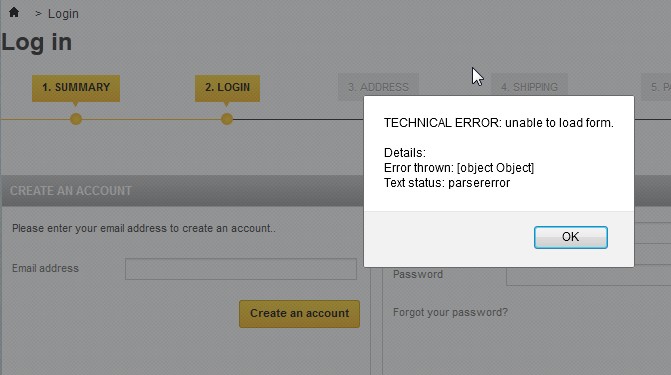

bruce-rez Posted June 25, 2013 Share Posted June 25, 2013 (edited) Hi, I get an error message on Log in page when I click on 'Create an account' after entering an email address. Error message: TECHNICAL ERROR: unable to load form. Details: Error thrown: [object Object] Text status: parsererror I've searched on line but couldn't find any solution or workaround. I would appreciate if anybody can give some info about this issue. I am on version 1.5.4.1 default theme. Please see the screenshot. Thank you Edited July 2, 2013 by bruce-rez (see edit history) Link to comment Share on other sites More sharing options...
vekia Posted June 25, 2013 Share Posted June 25, 2013 turn on browser console (shift+ctrl+J in chrome) and check console log, please paste error code here Link to comment Share on other sites More sharing options...

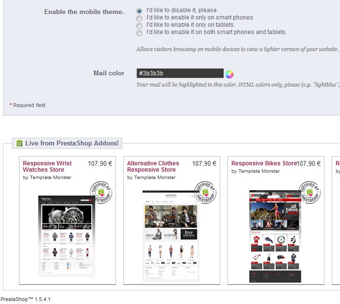

bruce-rez Posted June 27, 2013 Author Share Posted June 27, 2013 Sorry,I think I found it (see screen shot). I checked and saved the "I'd like to disable it, please." but it did not resolve my problem. see screen shot. Link to comment Share on other sites More sharing options...
