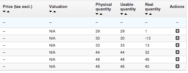

jc87 Posted June 24, 2013 Share Posted June 24, 2013 (edited) Hi, I have been using the AMS for awhile. Recently we just noticed that whenever our order goes through successfully (marked as Shipped), the "Real Quantity" deducts which is fine. But the physical/Usable Quantity stays the same, am I missing something or is there a bug? I am using 1.5.3.1 And also, whenever we try to decrease the stock level, but "Real Quantity" goes down to negative as well. Edited June 24, 2013 by jc87 (see edit history) Link to comment Share on other sites More sharing options...

jc87 Posted June 28, 2013 Author Share Posted June 28, 2013 I think I solved this issue. I forgot to link the warehouse to a carrier. So thats the main reason why the Phyiscal and Usable Quantity not deducting. 1 Link to comment Share on other sites More sharing options...
BoKr Posted August 8, 2014 Share Posted August 8, 2014 The last answer should be linked to a sticky topic! One you have set up your ASM and all goes fine you are highly prone to forget to link new carriers you might add to your logistics in the future. At least I am and was and so many articles are now represented with the wrong 'real quantity'. Only way to correct this for me is to go into the DB via phpmyadmin/heidiSQL and to adjust values there. You will find an answer to this on the forum by Vekia. http://www.prestashop.com/forums/topic/265524-real-quantity-problem/?do=findComment&comment=1324776 Link to comment Share on other sites More sharing options...
