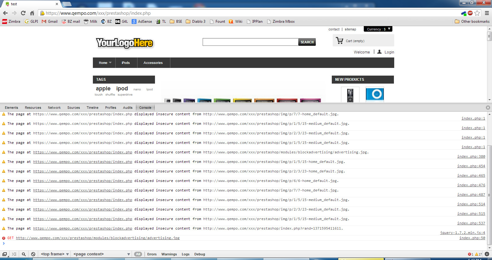

bzdevil Posted June 18, 2013 Share Posted June 18, 2013 (edited) I've been trying to make Prestashop work properly with SSL but I keep getting warnings about insecure content. This is a fresh default installation of Prestashop v1.5.4.1. You can check the site here: https://www.qempo.co...ashop/index.php SSL is forced on the webserver (nginx, not Apache). Also, PS_SSL_ENABLED is set to 1 in the database. I haven't changed anything else in the config nor added modules, altered templates, etc. Plain vanilla install, yet it doesn't work properly with SSL. There's a bunch of images sent via HTTP instead of HTTPS. In SEO & URL, SSL domain and shop domain are the same (www.qempo.com). No matter what I do, it keeps showing partial content via HTTP. Mainly product images are being shown via HTTP. I've read plenty of documents but so far I'm unable to pinpoint the source of this problem. I thought that with a default install I wouldn't see the issue but it's there. Please advice. Edited June 18, 2013 by bzdevil (see edit history) Link to comment Share on other sites More sharing options...
bzdevil Posted June 19, 2013 Author Share Posted June 19, 2013 nvm, fixed the problem adding this to nginx.conf fastcgi_param HTTPS on; Link to comment Share on other sites More sharing options...
