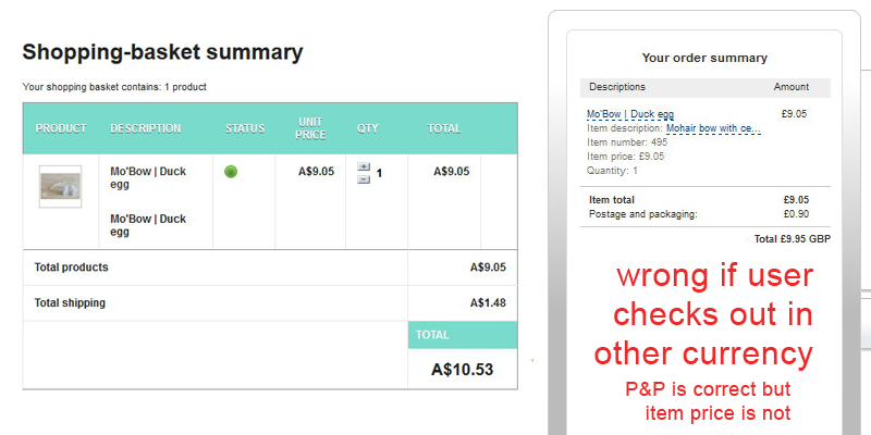

atwitz3nd Posted June 18, 2013 Author Share Posted June 18, 2013 Thanks Tomerg3 I'm running PP version 3.4.8. I did install the latest version but it didn't solve the problem. In terms of the currency and paypal screen, from the tests I've done, It parses the total values thru to the paypal screen, but not correctly, and doesn't use the correct $ symbol, see below: Shopping basket: item $6.43 P&P $1.56 Total $7.99 Paypal screen: (all in £ symbols) item £6.43 P&P £1.00 Total £7.43 GBP It's displaying USA total for the item and UK total for shipping, but neither with the correct currency symbol/codes.... I really can't work it out. Also, in the latest PP version, which file replaces the current payment/submit.php page? it's so different to mine.. Thanks again Link to comment Share on other sites More sharing options...

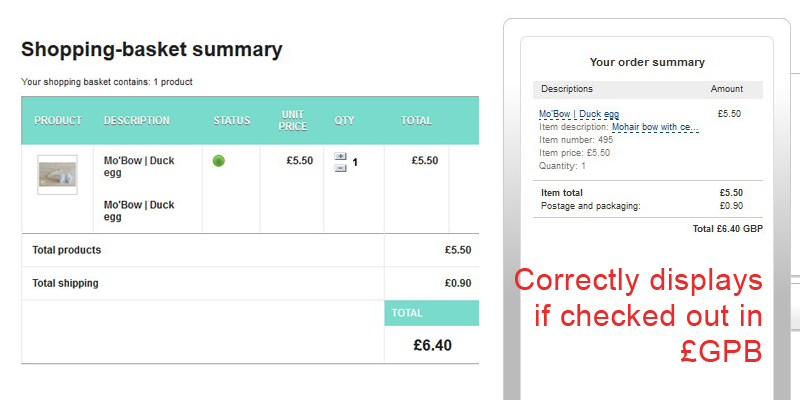

atwitz3nd Posted June 23, 2013 Author Share Posted June 23, 2013 (edited) Some more information: Just set up a sub-domain to my old prestashop 1.4.8.2 web store I've now established that it IS working correctly on that old version. Nothing in my paypal account has changed since then, so the problem only exists on 1.5.4, Either with the currency block, or the paypal module? Paypal mod has always been set up to accept pounds which is the shop default, but it's carrying the wrong total over to the paypal screen. I updated to PayPal 3.5 and this did not solve the problem either. I've attached some images. Any thoughts? Also, in the latest Paypal module, which file replaces the old payment/submit.php page? is it the 'process' page? Many Thanks Edited June 23, 2013 by atwitz3nd (see edit history) Link to comment Share on other sites More sharing options...
