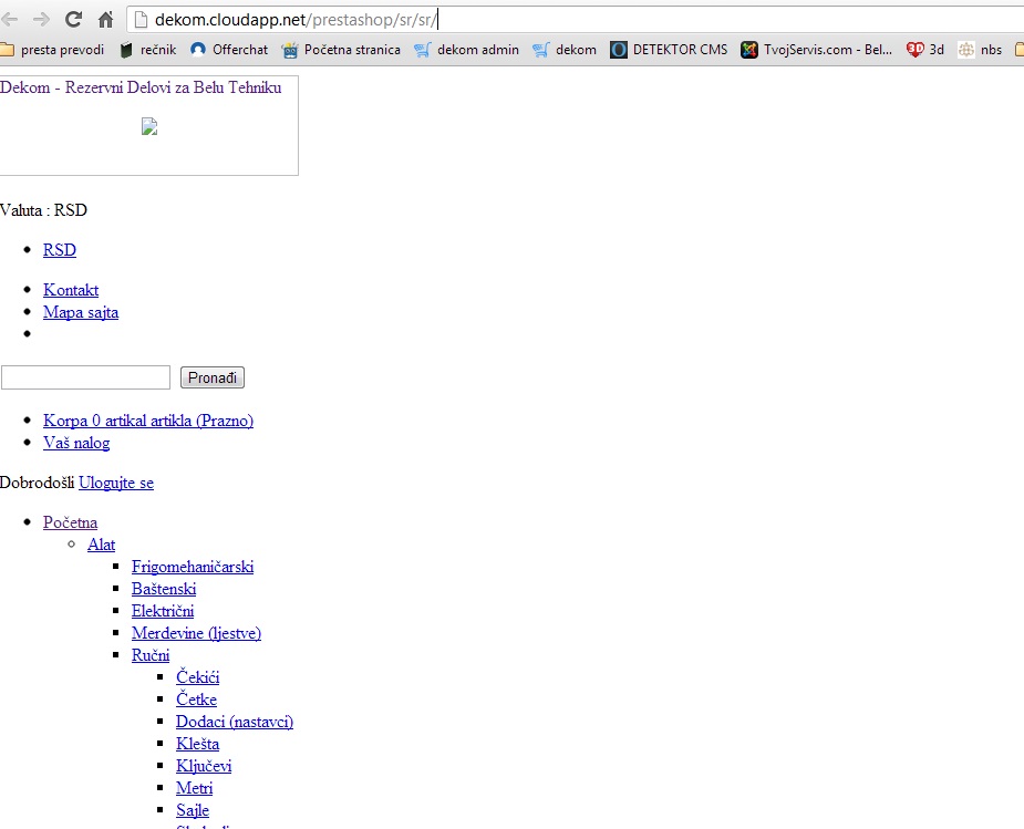

Dolke Posted June 24, 2013 Author Share Posted June 24, 2013 (edited) Thanks Bill. @yaniv14 I updated this value as you suggested but when I'm going to my front end it redirect me to prestashop/sr/ and gives me 404, object not found. I also tried to add prestashop/sr/ as my base URL and when I do that it loads the page as shown on the printscreen below. Any suggestions? Edited June 24, 2013 by Dolke (see edit history) Link to comment Share on other sites More sharing options...

Dolke Posted June 27, 2013 Author Share Posted June 27, 2013 (edited) Thank you. With the help from @yaniv14 I managed to make my clone website work on the MS Azure Cloud virtual machine. I must say that it is working slower (not to much though) then on the HostGator shared server. Problems with the CSV import functionality, image rebuilding, index rebuilding are also present, so changing the hosting environment in order to fix this issue hasn't been successful. Also I would like to thank Mr. Bill Dalton for noticing some vulnerable info that I have left in the posts and for clearing them from the topic. Thanks Bill. Edited June 27, 2013 by Dolke (see edit history) Link to comment Share on other sites More sharing options...
