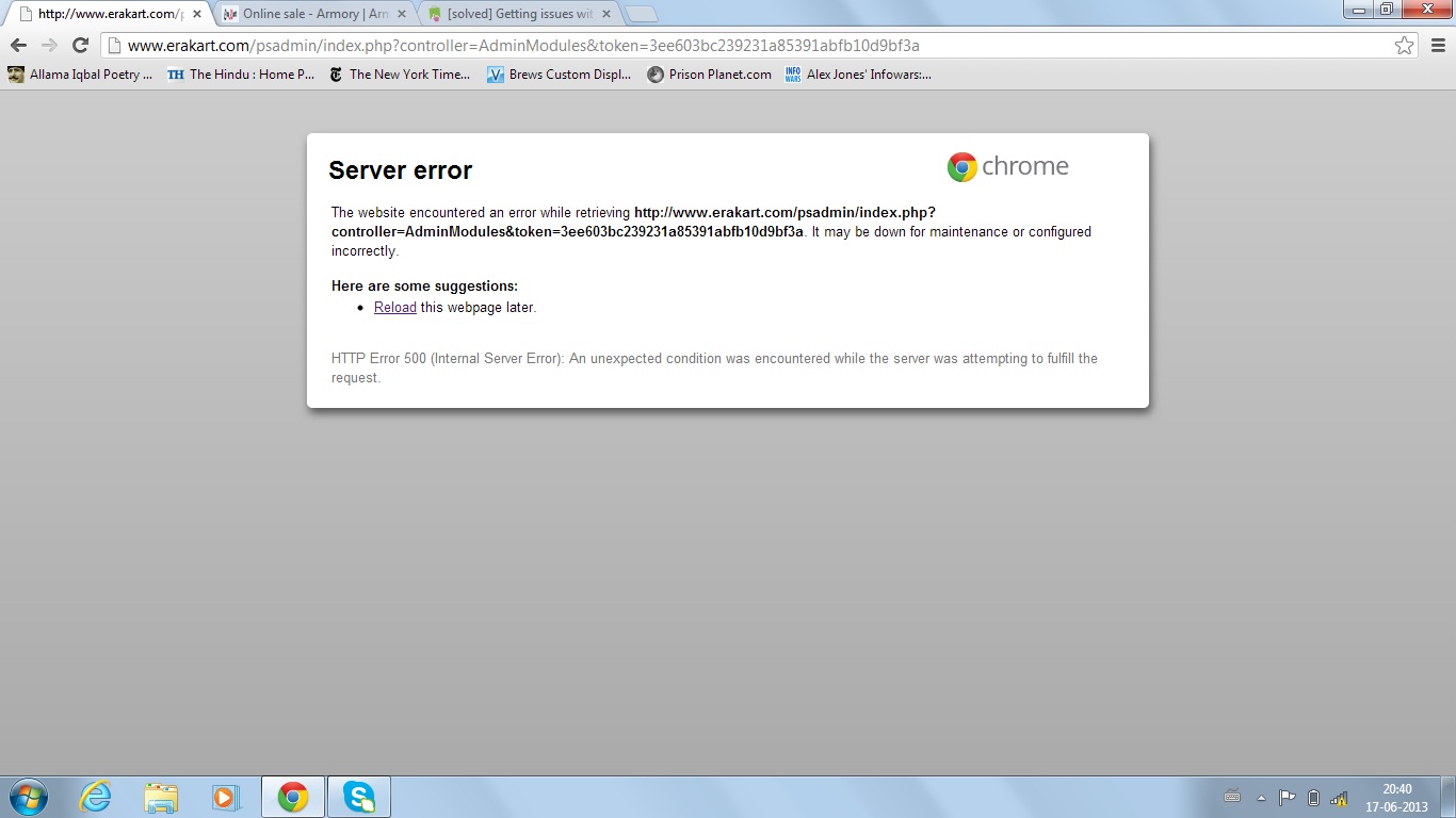

shariqafroz Posted June 17, 2013 Share Posted June 17, 2013 Hi I am using prestashop 1.5.4.1 Everything was working absolutely fine until today when I tried to upload a third party live chat module, Since then when I click on module link in Back Office it gives me an below mentioned error. The website is still working fine but I cant access my modules,, Kindly provide simple language solutions as I am new developer,, Kindly help..... screen shots attached.. website link : www.erakart.com Server error The website encountered an error while retrieving http://www.erakart.c...391abfb10d9bf3a. It may be down for maintenance or configured incorrectly. Here are some suggestions: Reload this webpage later. HTTP Error 500 (Internal Server Error): An unexpected condition was encountered while the server was attempting to fulfill the request. Link to comment Share on other sites More sharing options...

vekia Posted June 17, 2013 Share Posted June 17, 2013 you've got 500 internal server error because one of the module have got probably parse / php script error. the only way to find it is to turn on error reporting or the best: php error log. Link to comment Share on other sites More sharing options...
shariqafroz Posted June 17, 2013 Author Share Posted June 17, 2013 you've got 500 internal server error because one of the module have got probably parse / php script error. the only way to find it is to turn on error reporting or the best: php error log. Thanks Venkia,, I am really thank ful to you for all the support,, I found the error,, Despite restoring there were 3 folders which were not deleted from the module i installed,, I finally deleted these three folders and now the Module link is working fine.. Thank you for all the help, guidance & support,, could not have done without you.. You are a STAR Link to comment Share on other sites More sharing options...
