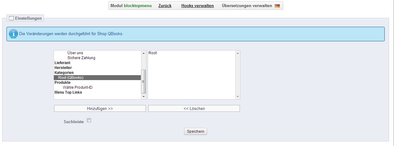

Deeo Posted June 15, 2013 Share Posted June 15, 2013 Hi, I'm just playing a bit with prestashop. I just dont get the categories to be shown at the top horizontal menu: - I added new Categories, marked them as root (even tried without root) - I added sub-Categories. - I cleared the cache (cache/smarty/cache and cache/smarty/compile) - I tried to add the Categories in the Modules/blocktopmenu section at the backend --> Here is the problem I see under "Categories" only one "Root(qbooks)", but I think, there should be the others, too. Shop-Url: http://shop.web240.server-drome.net Thanks in advance. Link to comment Share on other sites More sharing options...

Deeo Posted June 23, 2013 Author Share Posted June 23, 2013 Hi, Sorry, had a lot of troubles the last days. In the backoffice (i hope, you mean that by "BO"?!) I have under "Catalog" -> "Categories" 2 Main-Categories, each with 2 sub-Categories. All of them are active. (I can see them in the normal nav-Bar on the left side). @pascal: No, i didnt delete it. That is the problem, it is not visible if I only add the "root"-Category, to the top menu Link to comment Share on other sites More sharing options...

Deeo Posted June 23, 2013 Author Share Posted June 23, 2013 I did that already. I even deleted and uploaded/installed it again. It didnt work. I think I will try it at another webspace, as this is a clean, fresh prestashop installation and I am the only one with that problem. So probably it is something with the setting on that webspace. Link to comment Share on other sites More sharing options...
Deeo Posted July 2, 2013 Author Share Posted July 2, 2013 Just vor Info: new Installation -> the Module has now the correct language and I now see every category. So Things are fine now Link to comment Share on other sites More sharing options...
