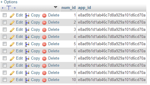

sacl02 Posted June 12, 2013 Author Share Posted June 12, 2013 (edited) AS you can see in the picture, when i refresh the back-office page it will register the same id over and over again...that table it's just to have one register. how can i fix that? Edited June 12, 2013 by sacl02 (see edit history) Link to comment Share on other sites More sharing options...
vekia Posted June 12, 2013 Share Posted June 12, 2013 make query to database SELECT * from TABLE where app_id='YOUR_APP_ID' if you haven't got this row in $result - add it to table, if you've got - do nothing Link to comment Share on other sites More sharing options...
