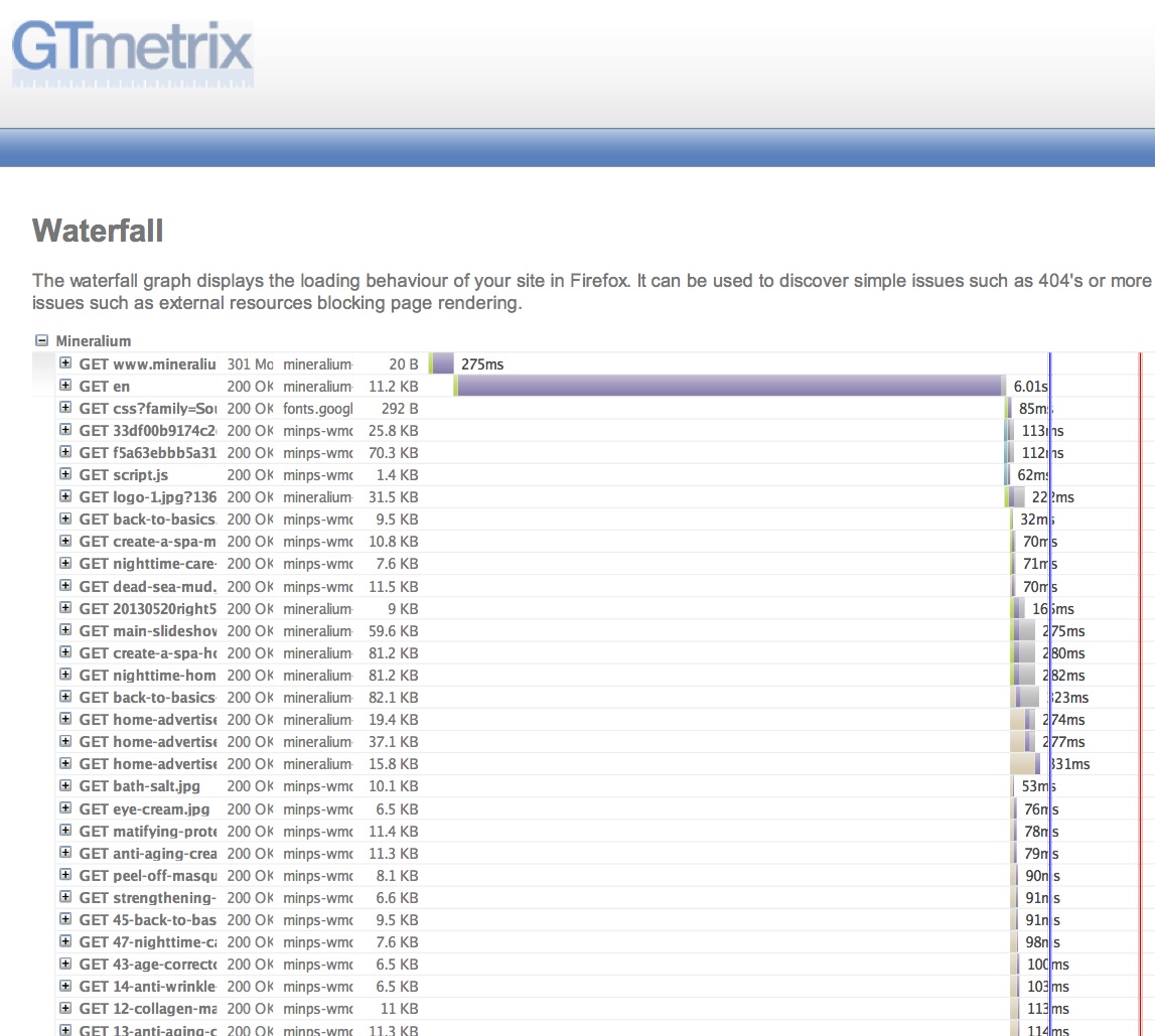

warrenm Posted June 11, 2013 Share Posted June 11, 2013 My site at www.mineralium-deadsea.com is experiencing extremely long load times for each page. The time to first byte is reporting as > 7 seconds and I have no idea why. More confusingly, the test site I have built at test.mineralium-deadsea.com which is almost an exact copy of the live site loads really fast (< 3 seconds). As you can see in the attached Waterfall analysis from GTmetrix, the browser simply waits and waits for a response before starting to load all the page elements. The server is fast, MySQL appears to be configured correctly. All other accounts on the server are fast including my test system. Both production and test sites are on 1.5.4.1. Can anyone help me? Warren Configuration: Server information Server information: Linux #1 SMP Tue May 14 20:38:14 MSK 2013 i686 Server software version: LiteSpeed PHP version: 5.3.10 Memory limit: 95M Max execution time: 600 Database information MySQL version: 5.0.96-community MySQL engine: InnoDB Tables prefix: ps_ Store information PrestaShop version: 1.5.4.1 Shop URL: https://www.mineralium-deadsea.com/ Current theme in use: warehouse Mail configuration Mail method: You are using the PHP mail function. Your information Your web browser: Mozilla/5.0 (Macintosh; Intel Mac OS X 10_8_4) AppleWebKit/536.30.1 (KHTML, like Gecko) Version/6.0.5 Safari/536.30.1 Link to comment Share on other sites More sharing options...
petrovv Posted June 11, 2013 Share Posted June 11, 2013 (edited) Hi Warren, This is not so much the software but on the server configuration. php set to: Memory limit: 128M Max execution time: 30 set all caching off on the Performance page (admin), except Smart Cache ccc (css,java). You memory limit (95M) is too low to use advanced caching. also LiteSpeed must configured correctly (listening closely), and xcache can also break many on the memory/cpu. Edited June 11, 2013 by petrovv (see edit history) Link to comment Share on other sites More sharing options...
warrenm Posted June 16, 2013 Author Share Posted June 16, 2013 Thanks for getting back to me but the server and its configuration are identical for the two sites. www.mineralium-deadsea.com and test.mineralium-deadsea.com are 2 accounts on the same server. Both have the same memory limit, max execution time and PS caching options yet the live site is slow and the test site is fast. Any other ideas? Link to comment Share on other sites More sharing options...

warrenm Posted June 18, 2013 Author Share Posted June 18, 2013 Hi, I've solved the problem so in case anyone else has the same issue, wanted to tell you that there is a bug with PS 1.5.4.1 in how it works with memcached which may drastically effect performance. By switching memcached caching off in the Performance page, I reduced response times from98 seconds to 3 seconds. I also have introduced Litespeed on my Linux server and set up a content distribution network (CDN) using cloud cache and my response time is down to around 1.9 seconds which obviously I'm very happy with. I assume that when PS eventually get the memcached problem solved and I switch it back on, I may even shave a little more off that time! This is documented elsewhere here and here and in github. Good luck! 1 Link to comment Share on other sites More sharing options...
