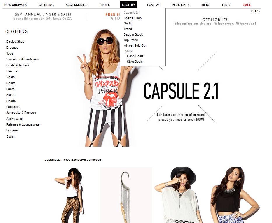

The Fuzzy Pineapple Posted June 5, 2013 Share Posted June 5, 2013 Hi! I would like to know how to make a collection that is not one for buying like a pack. I want a section in my shop that can just show something like a jewelry collection. I have attached a picture for reference. Link to comment Share on other sites More sharing options...

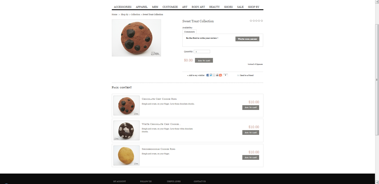

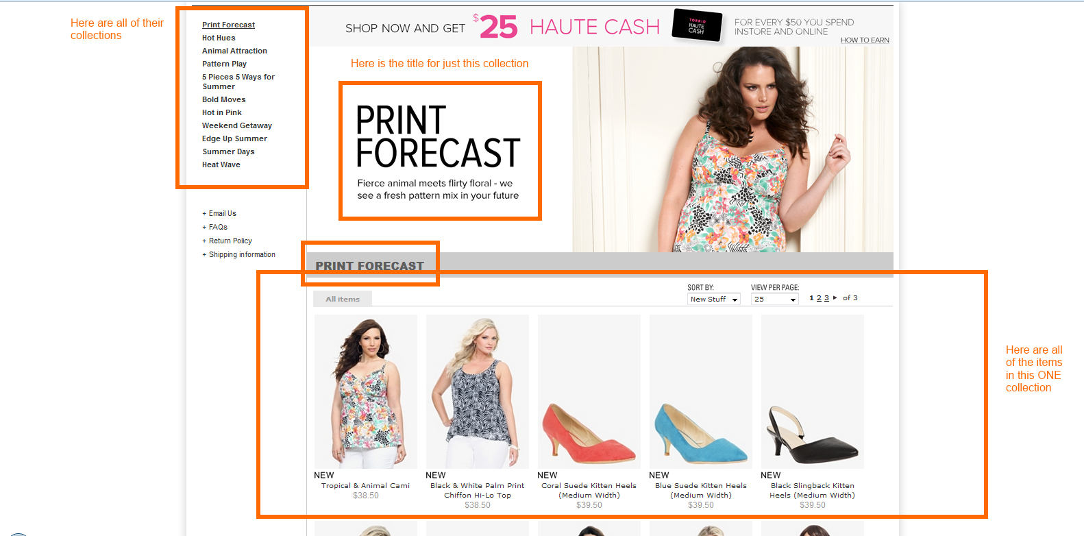

The Fuzzy Pineapple Posted June 6, 2013 Author Share Posted June 6, 2013 if is like the pictures, simply create a categoy and put your products inside. Thank you for your help. But alas, I tried that way initially however I have more than one collection. I made a collection category but all of the items from each sub category (the different collections) show up. I need a way to have multiple collections in one category titled collection. I have attached some more pictures of how I used the packs to solve the original problem however I would like to not use packs at all as it conflicts with inventory. The other pictures show how I would like to display the multiple collections. Link to comment Share on other sites More sharing options...

The Fuzzy Pineapple Posted January 18, 2014 Author Share Posted January 18, 2014 (edited) Hello everyone. Thank you for your help. However, making a category and then a subcategory does not solve the issue of products in all of the subcategories showing up together on the "Shop by" page. Otherwise, the "shop by" page will be an empty page. Again, I would like multiple collections. shop by >collection >collection #1 >collection #2 >collection #3 Here is the exact example of how I would like the page to function http://www.torrid.com/torrid/Collections.jsp Edited January 18, 2014 by The Fuzzy Pineapple (see edit history) Link to comment Share on other sites More sharing options...
