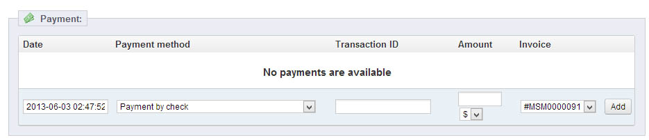

My site currently has payment setup for paypal, authorize.net, and checks however with placed orders upon review on the order details page in the Back Office, under the payment section it says:
No payments are available. These orders have the green PAYMENT ACCEPTED status.

Also attached what I am seeing, where the order appears properly paid for, but this area says no payments available. Am I just looking in the wrong place?
No special Database changes done offhand, the issue applies to all paid orders I've gotten so far.

Thanks again, I've uninstalled it for now in hopes to try again with new test orders. As a side note to the error, an example order number was MSM0000091 and appears that is too long since I get this error when trying to manually apply a payment:
[PrestaShopException]
Property OrderPayment->order_reference length (10) must be between 0 and 9
at line 837 in file classes/ObjectModel.php
Perhaps just a shorter invoice name setup would be fine, but appears that module needs some more work to avoid conflicts like mine. Too bad as it does seem weird for most people to have an invoice number be totally different from the order reference number as Prestashop is setup by default.

I had a similar problem.
order reference module is causing the problem
delete the modul and use this: http://www.prestashop.com/forums/topic/319928-configuring-order-reference/
